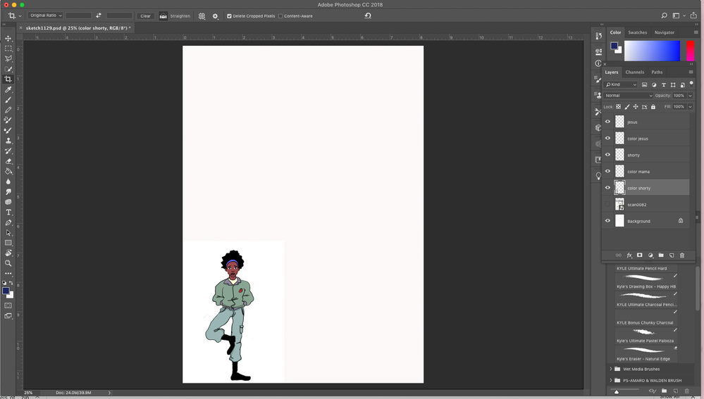

Hey. So i made a couple of sketches on a file and colored them seperately. I intended to crop the image and export anindividual sketch as a jpg, undo the crop, and export the next sketh.
However, after I cropped the first sketch and tried to revert the image to its original size, the other layers disappeared. They're in my layer box but they're not showing up  on the board. What do I do? I can't undo the crop anymore.
The first image is where I'm at currently, with the layers still there but invisible. The second image is what should be there after undoing the crop, minus the color.

When you crop, and want to revert, you need to make sure you DO NOT have delete cropped pixels checked. If you do, that part of the image is gone. You can go back in history, if you have not saved and closed the file.

This can lead to other problems such as larger file sizes. Cropping, logically to me, is deleting part of the image. If you aren't sure about your crops, try using guides instead.
Nov 30, 2019 Nov 30, 2019
Which method or command you are using to "revert"? You should not try to revert from File menu but rather use Undo command after cropping the image.
