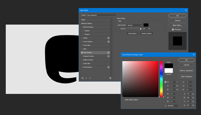

I think you hit the nail on the head--the answer probably is in your brush settings. It would be really helpful to see a screenshot of your document window with all the panels open.
The other thing you mentioned is that the brush only filled in your image to the level of transparency in the image--or to say it a different way, the brush only affected the pixels in your image. Did you possibly have "Lock Transparency" checked in the Layers panel?
This will give you the effect you are talking about. It is difficult to give you a better answer without seeing your workspace. Let us know if that helps explain it or if you still have a question.
