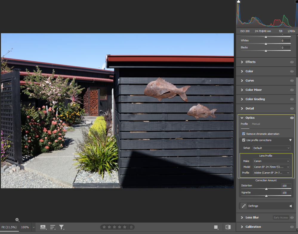

New Here ,
Apr 07, 2024 Apr 07, 2024
In my image, the pole is a little bent. How would I make it straight?
New Here ,
OK. The thing to understand about your image is that it is not just the flagpole that is distorted. The lens distortion affects all straight lines in the image, it’s just that the problem is most visible in the flagpole. Which means my previous answer still applies, you should adjust overall lens distortion. The demo below shows Filter > Lens Correction in Photoshop; click the Custom tab and adjust the Remove Distortion option until the flagpole looks straight to you. When I do it, the flagpole seems straight with a Remove Distortion value somewhere around -3.
In the demo below, first I adjust by dragging the Remove Distortion slider, but the second time I select the Remove Distortion Tool on the left and drag that over the image. Both adjust the same value, it’s up to you whether you’d rather adjust controls or the number on the right, or drag on the image itself with the Remove Distortion Tool.
