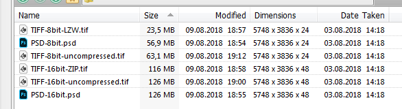

I have hardly ever used PSD because Tiff is the "industry standard", and I believe there are more applications that can open tiffs than PSDs. Tiff compression is also more effective than PSD compression, but I didn't know by how much, until I did this test:
An 8-bit tiff saved with LZW compression (lossless) is less than half the size of a PSD. LZW does not work well with 16-bit files, it can actually increase the file size.
The 16-bit tiff with ZIP compression (also lossless) is less than 10% smaller than the PSD, but it's still a reduction in file size.
The amount of compression will vary with image content, and for the record, here's the image I ran the test with.

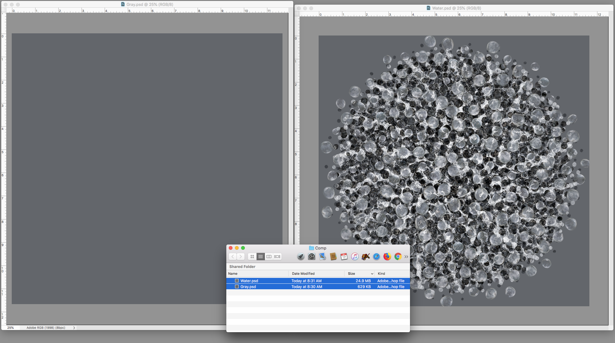

Aug 13, 2018 Aug 13, 2018
Both TIFF and PSD do some lossless compression, so repeating pixels would have an affect. These images are both 24-bit at 3000x3000 pixels, but there's a 40X difference in the saved file size—25,497KB vs. 629KB:
