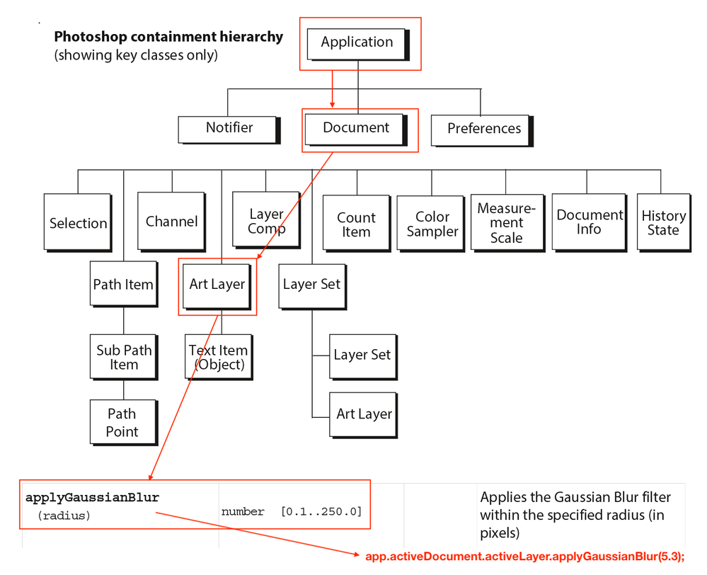

Hello all
Just getting started with scripts and JS, so I apologize if this is a dumb question.
How would I add a Gaussian Blur (amount 26) filter to my active layer using a script?
I have been experimenting but have not gotten it to work, thank you all in advance.

I still think looking at your current code would be best, however, without knowing where you are going wrong, the following diagram should hopefully help:
However, as the filter uses values in pixels, it is probably better to add further code to set pixels as the unit rather than just assume. This is probably OK for a simple filter, however, when resizing an image it pays to be specific.

Thank you so so much! That diagram definitely makes more sense now.
