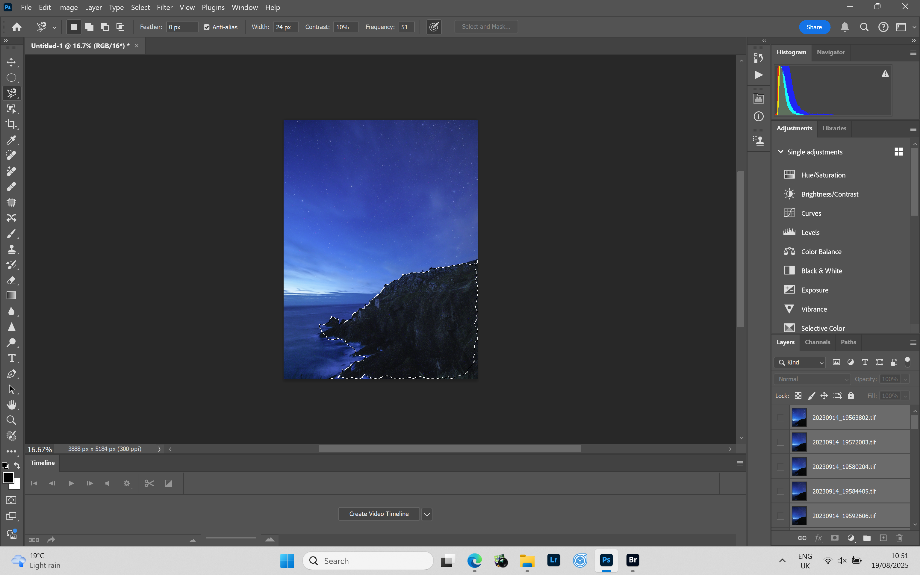

New Here ,
Aug 19, 2025 Aug 19, 2025
Thanks for the reply. I think my original post probably wasn't as clear as it should have been. (I blame age)
I've attached am image.
im looking to apply the selection (though it would be selected accurately) to the other layers
hope this helps
simon
The selection is independent of the layers... Apply the selection how?
Do you wish to copy the selected, previously adjusted "baked-in" pixels of the top layer to all lower layers, perhaps via copy/paste?
Do you wish to apply a recorded action that adjusts the pixels in one layer and run the selection and action to all other selected layers?
You can semi-automate this via an action, which would be run for each layer, then it would select the next layer, then you would rerun the action again as many times as required. Otherwise a script could loop over all layers automatically.
New Here ,
I'm looking to sort of "copy and paste"  the selection, on the other layers replacing the equivalent selection, so as the stars move and sky  gets even darker the headland stays the same level.
From that, save each layer as a jpg and create a timelapse video.
The Timelapse video I can do, it's the element of applying the selected headland/foreground to all the other layers where the sky has moved and foreground is darker.
my PS skills are fairly limited to a  few regular things I do.
thanks again for replying
@Chewie1965
The following script presumes a foreground selection based on the top layer content, and that the lower layer content to be replaced is "pixel perfect" in alignment. The pixels inside the selection are copied using the Apply Image command to each of the lower layers, limited by the selection. This way the sky in each layer will vary, with the foreground being the same.
After running the script, you can then select all layers in the layers panel (Select > All Layers) and then right click on a layer and use Export As to export all the selected layers to JPEG or PNG for making your timelapse animation from the separate "frame" images.
