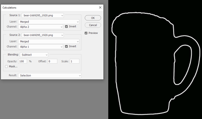

davescm
Sep 23, 2019 1:15 PM UTC
Hi
Try this
Duplicate the image layer
Make a selection of the image and save as Alpha 1
Select > Modify > Expand the selection by the required bleed width and save as Alpha 2
In Image calculations Subtract Alpha 1 from Alpha 2 as shown below and output as selection
You now have a selection around the edge - use content aware fill to fill it from the image
Dave
Feb 4, 2020 10:34 PM UTC
This solution worked very well. Just some minor touch-up, but otherwise this worked great!
Is this something that could be turned into an "Action"?
