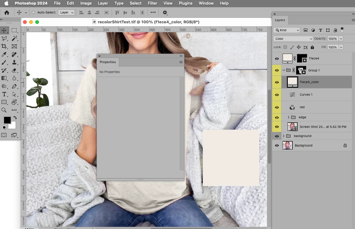

There are numerous ways to do this. I usually start by desaturating to a neutral color and then recoloring. Replace Color on a new layer and blended can work. Be sure to recolor any reflected tint in the scene as well.
July 8, 2024
Thank you for your response 🙂 Would you be willing to show the steps to do this in more detail? Im not quite understanding but it sounds like a good method. Im a little newer to PS.

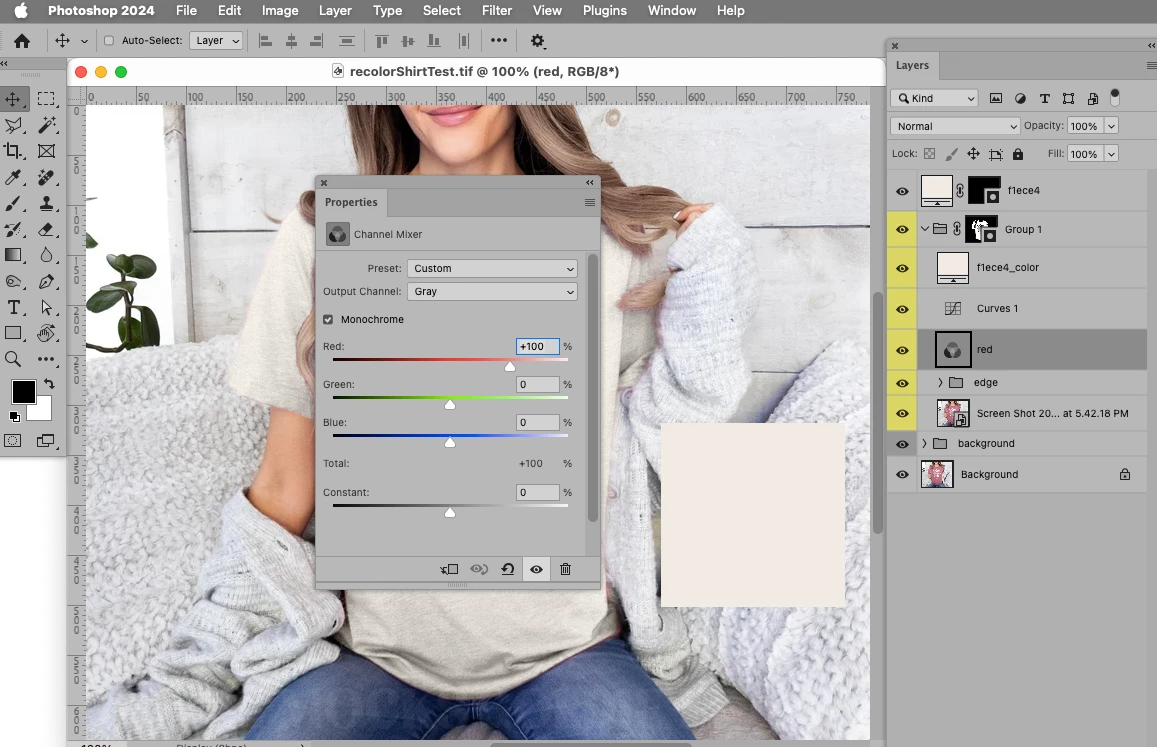

Sometimes using one Channel (in this case Red) via Channel Mixer as the basis of the Adjustments can be useful.
July 8, 2024
what did you do on the channel mixer? set to monochrome? would you mind showing photos of the settings you have within each layer? I keep getting a really gray undertone I cant seem to get rid of
c.pfaffenbichler
c.pfaffenbichlerCommunity ExpertCorrect answer
July 9, 2024

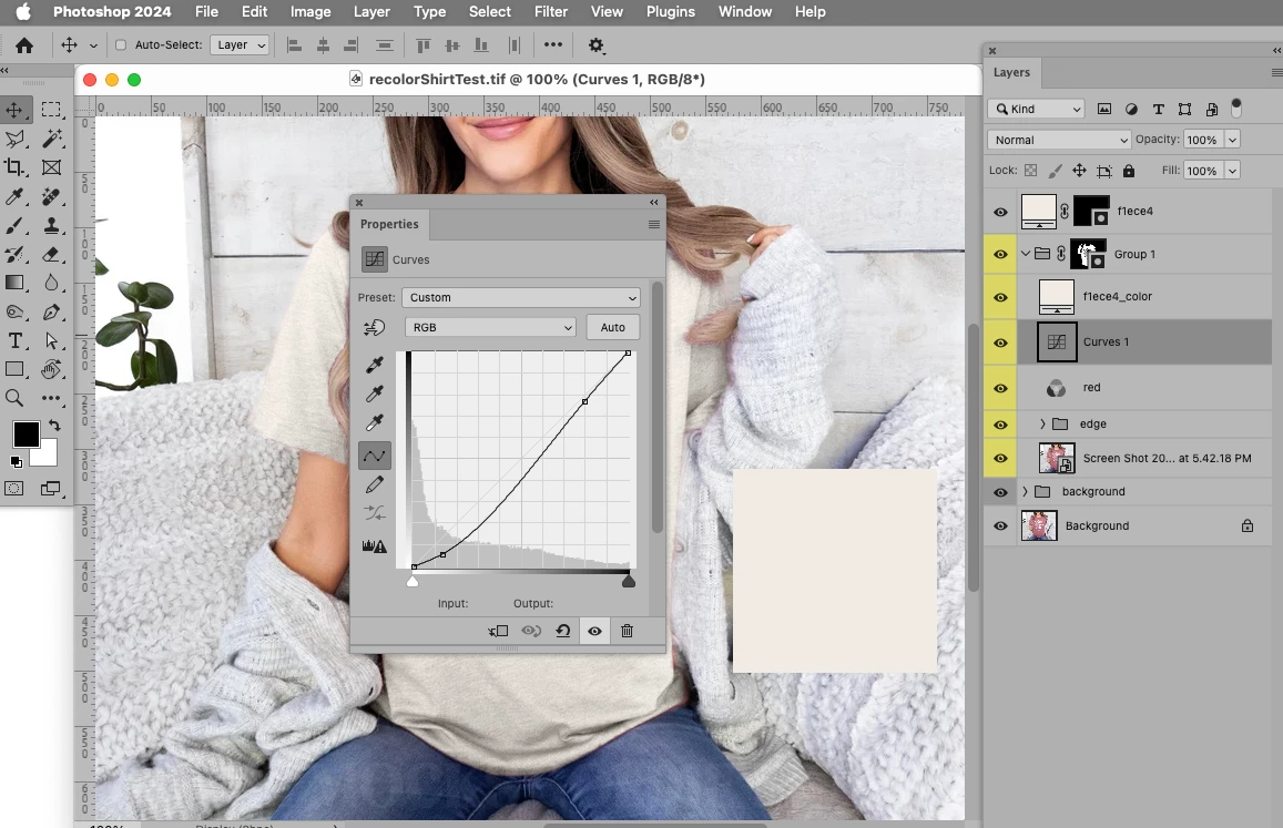

Chuck Uebele
July 3, 2024
For changing color of items, I like to use L*A*B* color. Your sample color was 94L 0A 0B, so basically your color is gray and the tone is just altered. In my sample, i set a color sampler to adjust the shirt. I could have used desaturation, but I used curves for everything - better if your target color isn't gray. So after I got the gray, I used the lightness channel to adjust the tone to 94L. First I moved the highlight end of the curve, till I got the 94. But the dark tones were a bit too dark, so I brought up the shadow end of the curve, till the shadows looked decent, then I readjusted the hightlight end of the curve to bring back the shirt to 94L. When doing this, you want to set your color sampler to what would be considered a middle value of the item: you don't want a highlight or shadow area.
