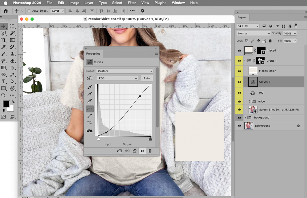

For changing color of items, I like to use L*A*B* color. Your sample color was 94L 0A 0B, so basically your color is gray and the tone is just altered. In my sample, i set a color sampler to adjust the shirt. I could have used desaturation, but I used curves for everything - better if your target color isn't gray. So after I got the gray, I used the lightness channel to adjust the tone to 94L. First I moved the highlight end of the curve, till I got the 94. But the dark tones were a bit too dark, so I brought up the shadow end of the curve, till the shadows looked decent, then I readjusted the hightlight end of the curve to bring back the shirt to 94L. When doing this, you want to set your color sampler to what would be considered a middle value of the item: you don't want a highlight or shadow area.

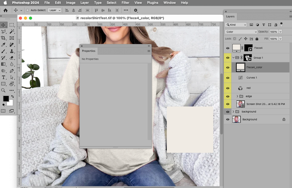

Sometimes using one Channel (in this case Red) via Channel Mixer as the basis of the Adjustments can be useful.

what did you do on the channel mixer? set to monochrome? would you mind showing photos of the settings you have within each layer? I keep getting a really gray undertone I cant seem to get rid of
Jul 08, 2024 Jul 08, 2024
Screenshot 2024-07-09 at 08.00.13.pngScreenshot 2024-07-09 at 08.00.17.pngScreenshot 2024-07-09 at 08.00.22.png

Try using the Curves Layer to brighten more.
And instead of a Solid Color Layer you could try usin a Gradient Map Layer (set to »Color« again) to emulate the more reddish depths against the more yellow brights.
