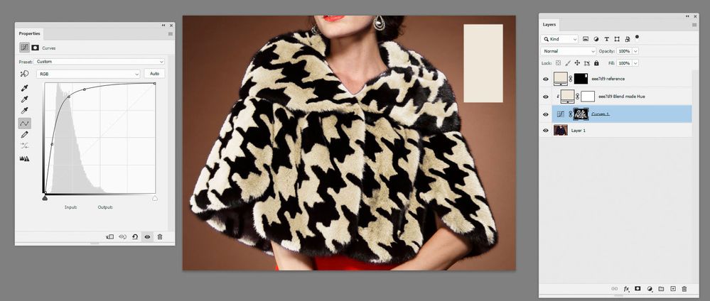

Hi
The issue you have is that you have been given a single value #eee7d9 which just means Red 238, Green 231 and Blue 217. Usually that refers to those RGB numbers in the sRGB color space.
However if you were to make all the purple colours in the jacket that exact value , it would look flat and painted - like a cartoon. So what you have to simulate is light falling on a material that is that colour. Where shadows fall it will be darker and where highlights fall lighter. There will actually be very few pixels that have that exact RGB value.
Look at the two images you attached (the purple jacket and the pink dress). The materials those garments are made of will have been a single colour, but the image pixels in those photographs are far from a single colour - in fact you probably won't find any that match the material colour exactly.
So whilst you can use a curve layer to lighten the jacket and a color fill layer set to hue blending mode to color it, a lot of the adjustment has to be done by eye.
Dave
