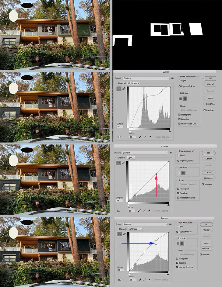

Oct 09, 2020 Oct 09, 2020
The eight images above should make the Lab sequence of steps a bit easier to understand.
  1. Your image with gray and green sections
  2.   A mask was created so that only part of the image would be affected, represented by white on the mask.
  3. The chosen area is changed to a common gray of Image 1 (rather than gray and green and…
  4.   A Curve was applied to the Lab Lightness channel to darken the color and adjust contrast.
Job done.
You asked how to make the affected area a bit darker.
  1. Opened the file. As a psd file the layers and mask are in place
  2. Chose Image > Adjustments > Curves, chose the Lightness channel, chose the Eyedropper and Cmd clicked on the existing gray. It put a mark on the Curve (See red arrow)
  3. Shows the result of using the up keyboard arrow to drag that value to a darker black tone. See blue arrow for before and after position of the tone.
