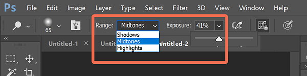

Look at the top where it says Range and Exposure.

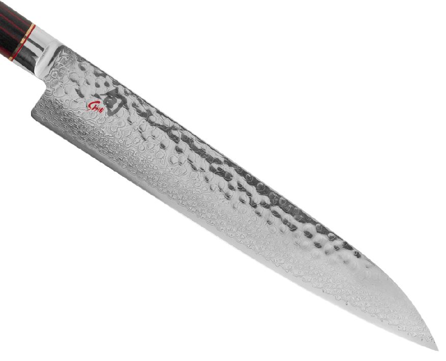

This is my image. I'm trying to lighten/darken parts of the blade and bring out the pattern. I've already done about 8 of these knives, and I've had success editing them using Dodge & Burn with low exposure. Just takes a bit of time and extra carefulness to avoid it being splotchy.
I just want to know if there's an easier way to use Dodge & Burn so that I can go over an area more than once while layering on the same amount of paint, but being at a low exposure. Otherwise, yeah, I'll give masks and adjustment layers and other techniques a go. Thanks for your help thus far.

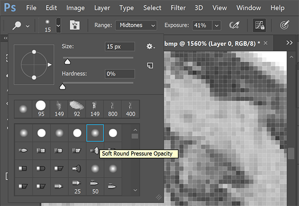

Zoom in.  Try using a small, soft round brush with hardness at 0.

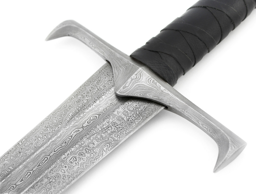

Lisa, (is that right?) from what I have seen of Damascus steel blades, they tend not to have strong contrast between the light and dark tones, but it is local contrast that you need to target, so a Curves layer might be better.
Selecting just the blade shows up the tonal range of the Damascus pattern so you can target it with the curve profile.
Then run a gradient up the blade in the curves layer mask, to even out the effect
BTW I'd hate to be asked to simulate that pattern just using Photoshop.   With your knife I'd be inclined to photograph it again taking lots of care with angles, and using carefully placed dark and white cards to accentuate the pattern.  Rather than light it directly, I'd light the white card placed above and behind the blade.  Imagine that the blade is a mirror, and place the white card so that you would see it reflected in that mirror surface when viewed along the camera's lens axes.

Thank you so much for all the information. I did end up taking some new photos, because the initial one wasn't the best to begin with. The problem with the blade is that it's also hammered, so the light reflects off in so many different ways, it's a pain in the ass to try and get a good photo while controlling the lighting. Still trying, using a light box, but I might have to switch to the white paper as the blade is quite long.

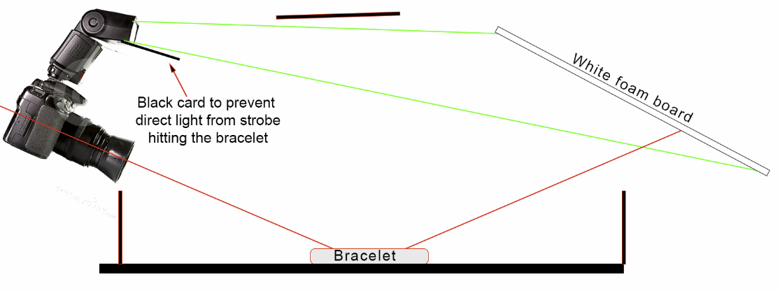

A light box will just make it look flat and boring.  I took this bracelet photograph six years ago as a demonstration in a lighting workshop. The person who was making them had tried using a light tent and was not getting great results, so I showed how to do this with a camera mounted speedlite.
https://c1.staticflickr.com/5/4034/4713385909_0780c1ac75_b.jpg
You might need to click to expand the illustration below.  The flash head is tilted up so it is directed at the white foam board above and behind.  The black flag (card) under the flash is important, as it prevents the flash lighting the product directly, so what you effectively have, is a large softbox behind and above the product.
Your knife blade is flat, so you would not need a large white area as was necessary to cover reflection from the curved bracelet.  The additional black cards can be experimented with or left out, but the way to make things look metalic is to have areas of bright highlight and dark shadow.  Go look at something made of chrome as an example.  This is also an excellent way to light food, but you'd need a white reflector between camera and the product/food dish to give some fill.
