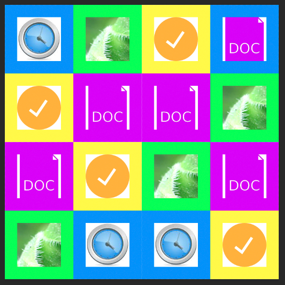

I've tested the photomosaic with a few small pictures and the color analyzing and comparison seem to work fine, but not for every tile:
(Please dont mind the black frame)
As you can see most of the sample images are placed properly in their tile (there's a resize function missing, so it's not stretched to the tile size yet).
Two things which seem to be kinda off:
1. Analyzing the blue tiles give me more than one most dominant color, theyre both pretty close though. I was thinking that it was because the function mostDominantColor gets too close to the edge and thus gets a brighter color from yellow or a darker from green?
2. Using the weigthed eucledian algorithm puts the pink doc image over the blue tile on the top right. Any ideas why? The distance is about 20 off to the blue clock, could that be the cause from the problem mentioned above?
I would appreciate your thoughts on this!
The full code is kinda long, so I dont think posting everything in here makes sense. I hope I could make it understandable, if not feel free to tell me!
PS: Using Lab makes sense I guess, but If possible I'd really like to stick to my rgb functions.
Edit:Individual pixels: Yes. The script looks for individual pixels only. I was thinking of using the color sampler with a sample size of 10x10, but I havent figured out how to do so yet. I'd like to try that, if any of you have a hint for me how to do it in Extendscript!

Another thing: I think the Sampler should be at (0.5, 0.5).
Does it make a difference in your measurements?
I am unsure what you mean by »puts the pink doc image over the blue tile on the top right« as I don’t know the listing parameters and the intended order.
What is »dominant« exactly – more than a certain percentage of the total number of pixels, simply the most numerous RGB value combination, …?
Copy link to clipboard
Copied
"I think the Sampler should be at (0.5, 0.5)." - I tried changing it, but that doesnt change anything. It is the first color Sampler added, so this position is only concerning the very first one (I cant move the sampler, without adding one colorSampler first).
"I am unsure what you mean by »puts the pink doc image over the blue tile on the top right« as I don’t know the listing parameters and the intended order." - If you look at the blue buttom tiles (the two in the background, the sample image with the blue clock) is properly placed on the blue tile. But if you look on the top right blue tile, the pink DOC picture got placed in there, which should be the blue clock.
"What is »dominant« exactly – more than a certain percentage of the total number of pixels, simply the most numerous RGB value combination, …?" - Yes exactly! As you can see I divded the picture in customHeight = doc.height / 10 and the customWidth = doc.width / 10. Which means 10 pixel per line * 10 pixel per column. So from 100 colorsamplers im taking the one rgb value which appears the most. (I guess I really need a way to implement using 10x10 average pixels as one colorsampler, but I havent figured out how to do that just yet).
Thank you for the link, I'll definetely look into it!
Im terribly sorry for only being able to provide the information part per part. I hope my intention is not too confusing though, really appreciate the help!!
