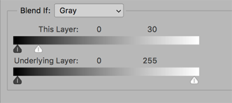

If this is the  result you are looking for:
Add a blank layer below the image layer (Option: White layer)
Choose the top layer and double click on it to bring up Layer Style
In the Blend if section slowly slide the top right slider to the left until all the color in the image is eliminated.
Flatten the image.
