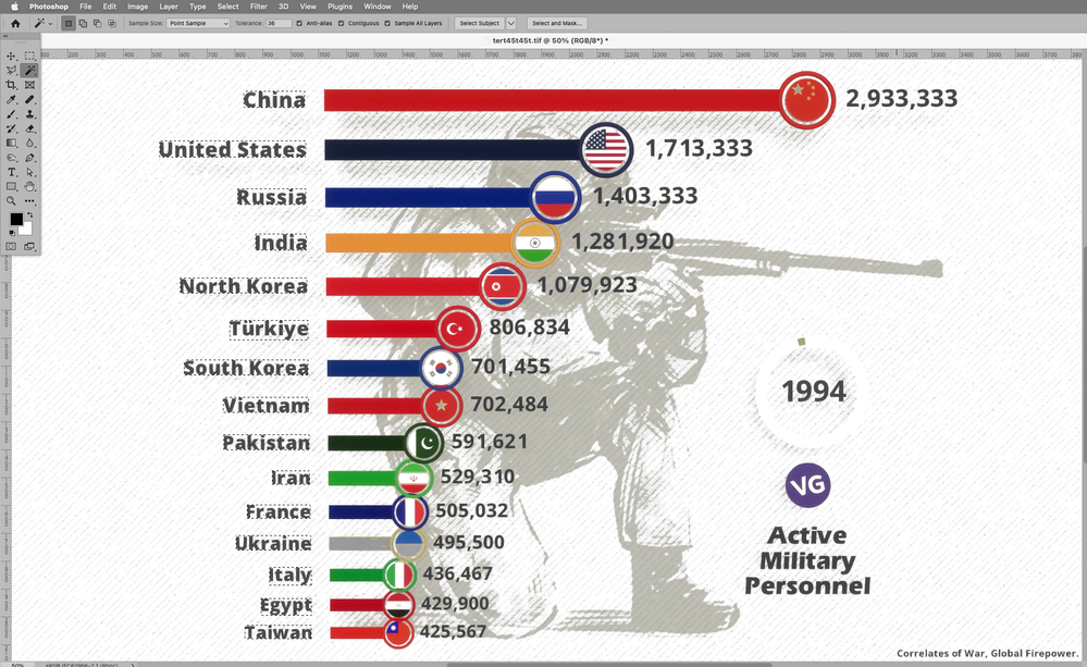

I have some chart images that i can select all left side texts by color range tool like following:

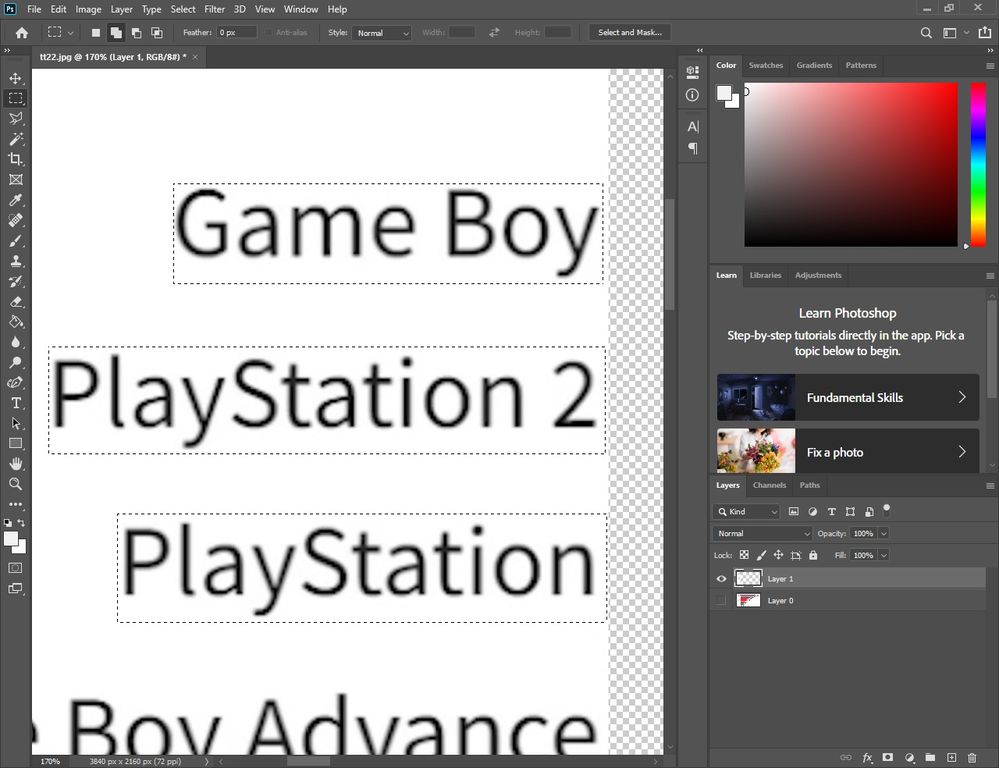

Now i want to convert all selections to rectangular selections like following:
Are there any script to do this conversion?
please note that I have manually selected only the first three words in the second screenshot to clearly explain the problem.
I attached sample image for test.

c.pfaffenbichler
June 15, 2023
I forgot to delete the line
executeAction( stringIDToTypeID( "revert" ), undefined, DialogModes.NO );
that I use for testing.
July 6, 2023
I think it’s the colorful background.
With this version of the image with a sloppiöy neutralized and lightened background it seems to work.
quote
By @c.pfaffenbichler
can you check attached JPG file and tell me why script not working on this sample?
Myra Ferguson
June 15, 2023
I'm not aware of a script. However, because there are bars to the right, I'd use them to make the selection. Here's one way to use the bars to make the selection:
  1. Select the Magic Wand tool
  2. Shift + click on each of the bars in the bar chart
  3. Select the Rectangular Marquee tool
  4. Hold the Alt (Windows) or Option (macOS) key and starting from the bottom rectangle subtract from the selection so that all the bars are the width of the Sega bars
  5. Press Q or go to Select > Edit in Quick Mask Mode (the selection becomes white and the non-selected area turns red)
  6. Select the Move tool
  7. Hold Shift to constrain movement horizontally and drag to the left
  8. Drag from the small box on the center right of the bounding box to widen the bars (hit Enter or Return or click the checkmark in the Options bar to accept the widening)
  9. Press Q again or go back to Select > Edit in Quick Mask Mode to toggle off Quick Mask Mode
June 15, 2023
quote
By @Myra Ferguson
tnq but we can't use right bars for select because some of chart images have zero (0) values and there are no any bar between left side text and zero values!
