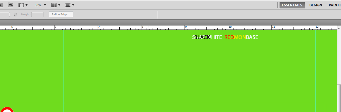

I think we are on the right track, this is what I ended up with after running the below (I made a few changes to make text bold and in all caps)

Guru ,
Jul 26, 2013 Jul 26, 2013
I think we are on the right track...
Note sure if that means you are happy or if something else needs to be done.
New Here ,
Actually, this works great.  It doesn't matter if they overlap.  Thank you very much for doing this for me!  I have a couple other ideas I'd like to try to do also if you have the time.  I will send you a pm on those.

New Here ,
Jul 27, 2013 Jul 27, 2013
This works well, I edited out the bottom left and right marks, but it appears that it only places the marks on the Red, Green, & Blue channels.

Guru ,
Oops, replace the for loop with this one.
for(var channelIndex = 0; channelIndex<doc.channels.length; channelIndex++){
    var newTextLayer = textLayer.duplicate();
    doc.activeLayer = newTextLayer;
    newTextLayer.textItem.contents = doc.channels[channelIndex].name;
    loadActiveLayerTransparencyToSelection();
    doc.activeLayer = currentLayer;
    doc.activeChannels = [doc.channels[channelIndex]];
    doc.selection.fill(black);
    doc.selection.deselect();
    doc.activeLayer = marksLayer;
    selectComponentChannel();
    newTextLayer.remove();
New Here ,
Thank you sir!  This works great, and saves me probably 10 minutes per job when labels and marks are missing.
