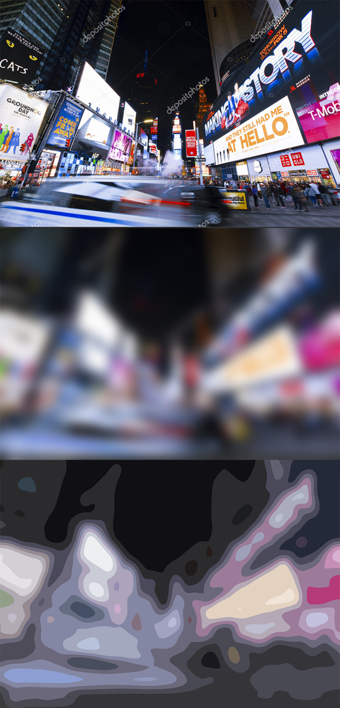

This shows original, gaussian blur (20 pixels) and cutout.  Obviously the original image will make a lot of difference.  There would have been a lot of blur to get those multiple light tones in your example.

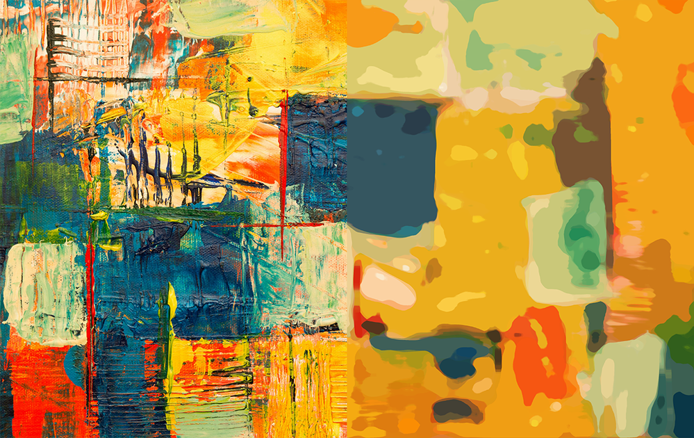

Strong Gaussian blur, and high value Median.  Original on the left.

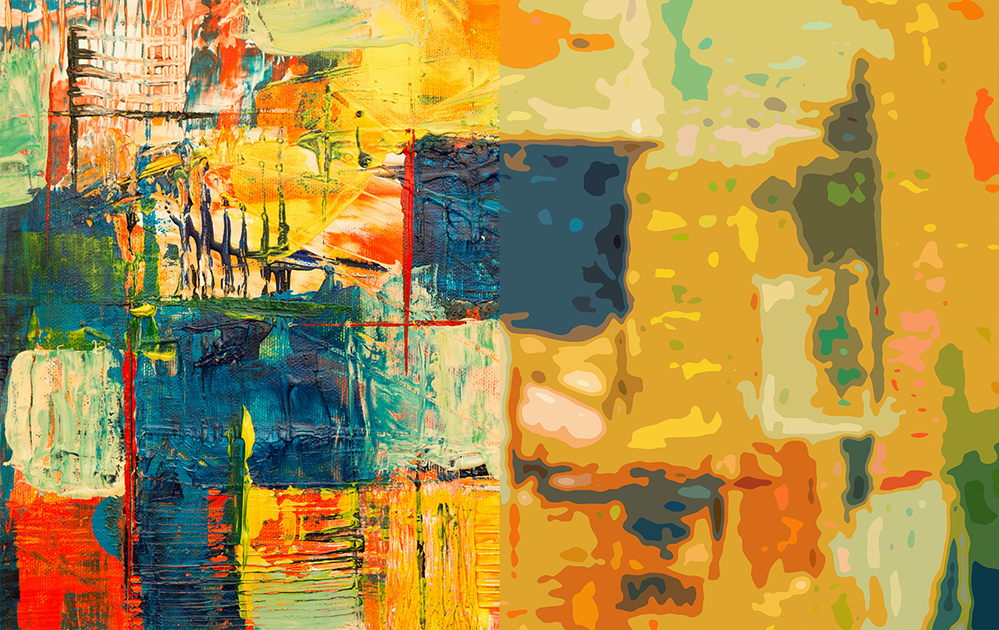

Similar Gaussian blur, and Cutout 8,0,0
Without the blur, the shapes are much more angular.

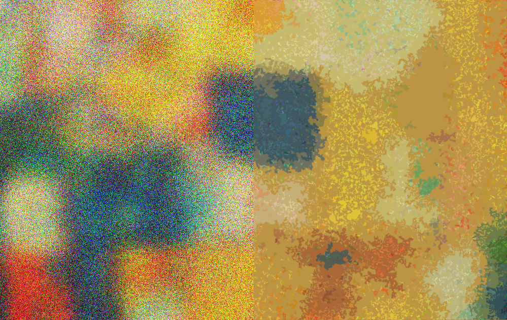

You can make the pattern finer by adding noise (left side) before Cutout/Median (right side).
