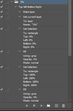

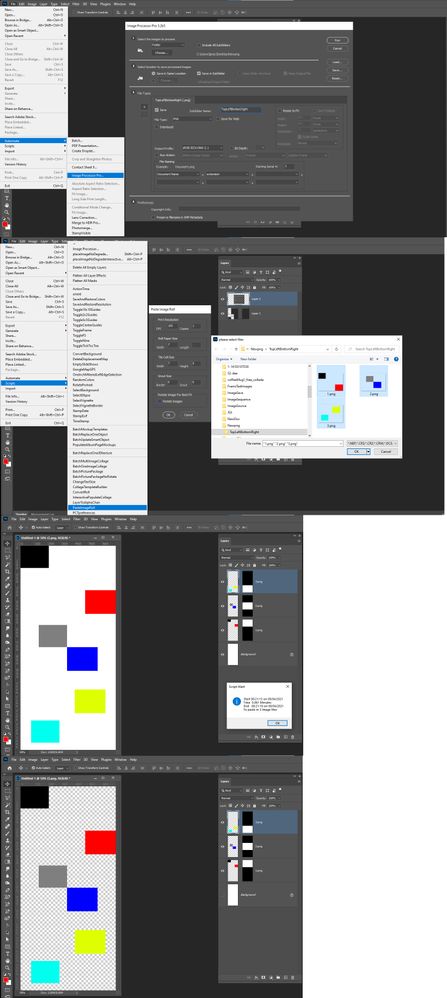

If it did not align because your Png  files subject matter has transparent border(s) eliminate that issue remove them  I batch an action to do that. Batch will overwrite your png files they will not have any transparent borders but will look like they do. After that use my script or the Scripts_Related_to_Montaging.

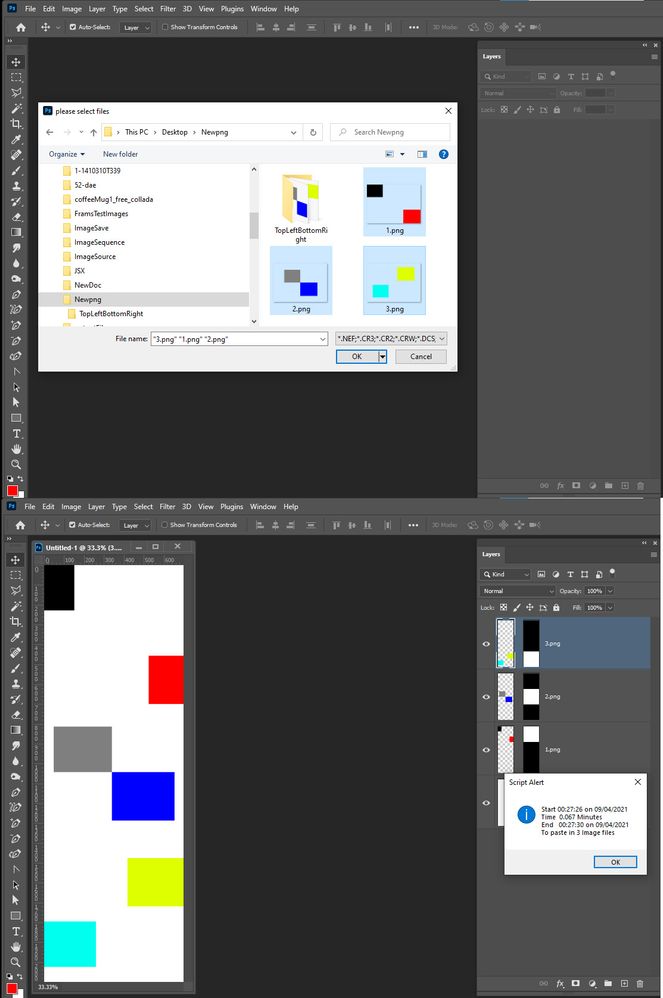

If you just need to stack them the canvas size would be 580x580 you could use Loads files into a stack.  You seem to want to distribute the layer down a narrow tall canvas that is near Photoshop limit of 30,000px. My script should be able to do that. However,  the way my script works its does a copy and Paste Into Between documents.  The 580x262740  document would have a White Background  layer the Png Image layer would be pasted into the document over the document casvas and masked to appropriate  580x580  px area by "Paste Into". The thing is I believe if a png is copied to the clipboard has any transparent boarders the boarders will not be copied to the clipboard only the PNG subject pixels are copied to the clipboard,  In effect the png is trimmed  to its subject matter.  If I'm right your png images may no align the way you want then aligned by Paste Into. You would need to write a script to place in your 453 pngs and distribute them over the canvas.  Or you may be able to use Load Files into a stack to a stack to stack your Pngs then Add canvas to the height and distribute the stack of png images.
I think any png that has any transparend boarder  its subject matter would be centered in that Pasted 580x580px tile area.

Sep 03, 2021 Sep 03, 2021
Did you try the 1% work around?
JJMack

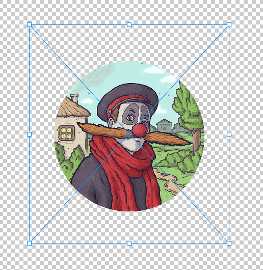

Because their files are 580x580 px png files that may have transparency when they are loaded into a stack  or dragged into a stack I think their layers bound  may not be the 580x580 px square canvas bounds the png file canvas has the layer bound may be just the png subject bounds.  It my be interesting how distribute layers works then.

Mentor ,
Sep 02, 2021 Sep 02, 2021
When we drag a file into the working area of the document, Photoshop creates a smart object. The outer rectangle of placed file is determined by file boundaries, not transparency.2021-09-03_09-04-06.png

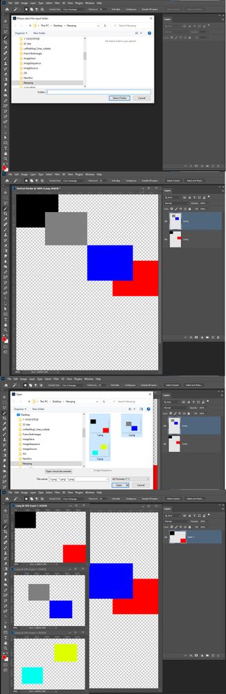

@rickyzg
Please try the following script, test with a folder containing a smaller set of images first to ensure that this works as desired. Files are stacked in alpha/numeric sort order.
Files to Vertically Stacked Layers.jsx
Did not work for me.
This Did
where this did not
JJMack
