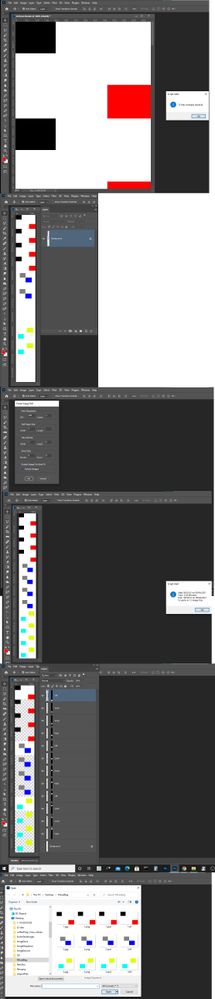

Sep 04, 2021 Sep 04, 2021
Thanks JJMack, it was all fine this morning otherwise I wouldn't have posted... Anyway it is of course coming up with errors and different behaviour that was not there this morning!
I have updated the script code to a 1.1 version...
I still can't get the same result as you, it works fine for me. All input files have the same canvas/pixel width/height.
There is still a problem in your new version.  I ran it with the png with the transparent boarders and the one I add  the top left bottom right pixels. Your script still lost the third png bottom transparent boarder.
JJMack
¯\_(ツ)_/¯
Here one more test
JJMack
Sep 05, 2021 Sep 05, 2021
@rickyzg
My script works fine on my system, using images of the same width and height with no transparency.
JJMack has unexpected results on his system with his test images. I can't comment on that, it works for me and nobody else has commented or tested to provide further positive or negative feedback...
So I'm obviously interested in how the script works for you?

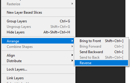

LEGEND ,
Wow, I didn't know there's stringIDToTypeID("reverse") in Photoshop working on selected layers!
Mentor ,
This is the first time I see this menu item, although it has been there since at least CC2014 🤦
LEGEND ,
Of course I checked in no time where it is in menu, then launched CS6 and it was there too.

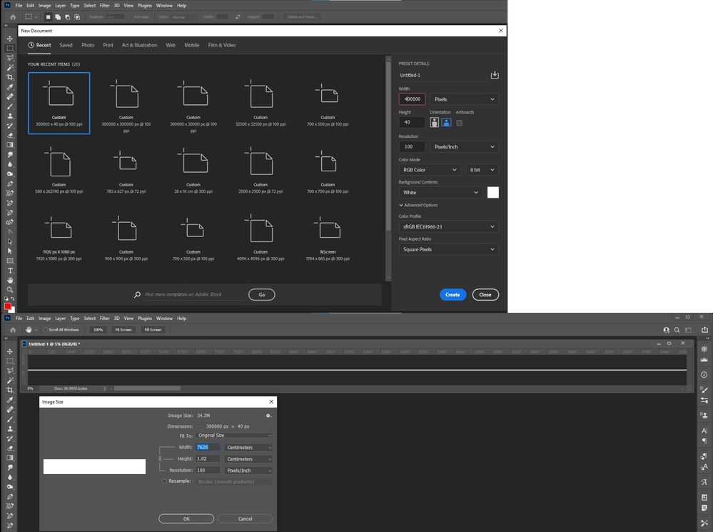

Photoshop seem to have a issue these days knowing what limits it has. I seem to be able to create a document  with a 300,000 px width.    I can set 400,000px in the new document width field Photoshop will not complain or change the setting.  It will  just create a document 300,000  pixel wide.   Photoshop has issues. Adobe need to do better testing than they do.
