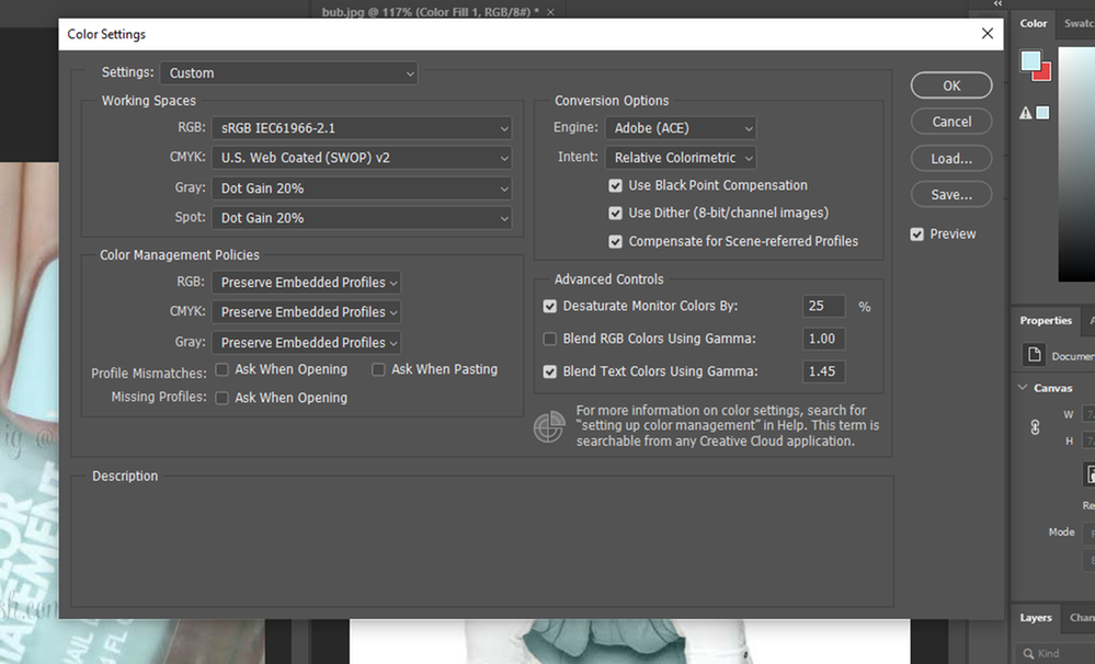

I have tried changing the colour settings, and also have tried turning down the computer saturation to lower but it still doesn't show the colours to be soft and how I need them.

On no account mess with your monitor settings to get things to look better. Because it means your monitor is out of step with all the other monitors, and will convince you your colours are right, when they are not...

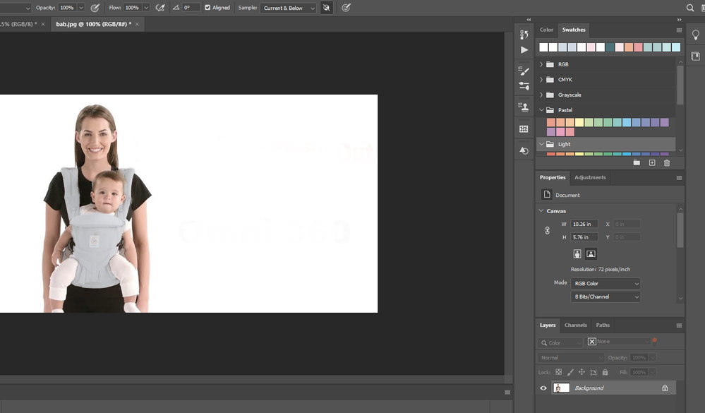

Here's a couple of things that may help in creating pastel colours.
Within the Swatches panel is a Pastel section that can be opened up.
When you open up a colour within the Color Picker keep an eye on the Saturation value. You can manually adjust this number and generally keep it low.

Jan 19, 2020 Jan 19, 2020
Photoshop contains an actual Swatches panel that can be found under the Window menu. This panel recently got a dramatic upgrade in terms of both content and appearance. My screen grab was from Photoshop 2020. What version of Photoshop are you using?

I think i am using Photoshop 2020.
I found the swatch panel. From here the colours look more accurate to the swatch when painted with the paint brush but it gives it a very unnatural look because all the texture of the baby harness isn't visible or is only just visible.
I painted the harness blue-grey using a colour from the swatch but with bad results.trial.PNG

Participant ,
Attached is also a screenshot of my photoshop remi.PNGolour settings.

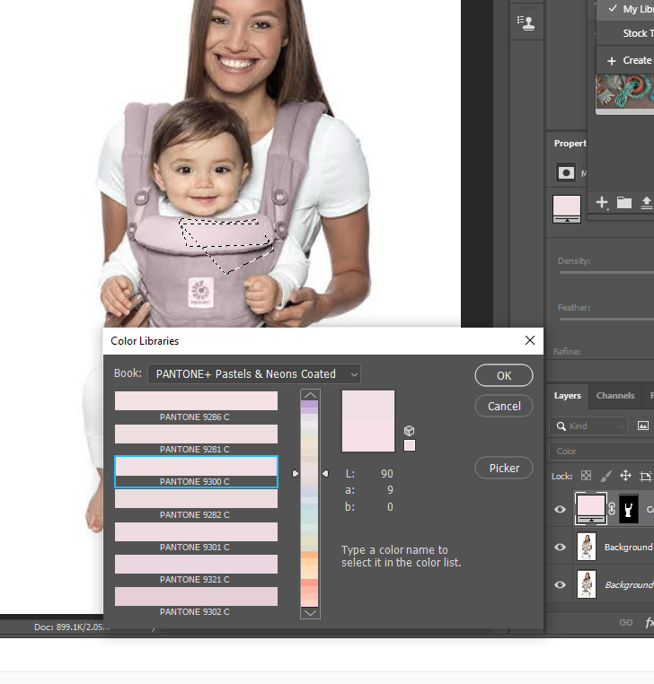

Participant ,
I have below attempted to pick a pastel colour from the library but the end result is not the same shade at all. The picker is light cornflower blue but the end result on harness looks darker and harsher.
The saturation is low at 18%.
If i put it much lower it becomes grey. It i put it just few percentage lower it just heads towards grey but not towards looking like the colour in the picker.
Jan 20, 2020 Jan 20, 2020
This requires a good eye and a bit of experience. I normally hate to use the words "it's complicated", but in this case it really is. These are quite complex optical phenomena.
For one thing, highlights tend to be bright regardless of the base color, because they often consist mainly of reflected light. For the same reason, these highlights are lower in color saturation.
Shadows usually decrease in saturation. Deep shadows have very low saturation. None of that means you should go crazy with the saturation slider, it's quite subtle, but subtle goes a long way here.
A black/dark object has low total contrast range, the highlights are very deep - unless it's reflected light. A bright object has a very wide contrast range. In between, the contrast curve itself varies.
In short - this is really a lot more difficult than most people realize, and just putting a solid color layer on top of a white object will never look natural.
Sorry to be the bringer of bad news... 😉
