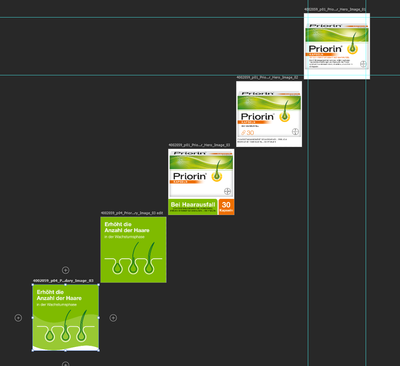

How to Export to artboards using the photoshop variables
I know how to export to each psd file using the photoshop variables.
But I want to know how to replicate artboards with the data in my csv file.
