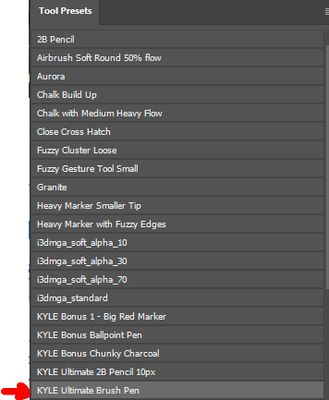

For anyone still looking for a solution/workaround in 2025, here's mine. Im using release 26.11.0.
  • Select the brush tool > go to the Tool Presets panel > select the brush you want to use(in this example Ill be using "KYLE
Ultimate Brush Pen") . See Image 01
