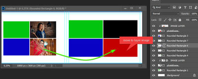

How to move the layer with the help of script and place it on another layer. is that possible ?

Thanks to Reply.. but I need Place or move  single layer. Place only image layer from selected 2 layer... plz watch video
Explorer ,
Feb 15, 2023 Feb 15, 2023
I want to place the clipping mask layer on another layer.. Only single layer should be moved. is it possible with script48Lkdn3wRM.png
I'm a bit confused. If the video demonstrates the process you want, then what is the problem?
Is the video a "real time" recording, or did you create the video to demonstrate the process that you want scripted (therefore it wasn't a live recording)?
It also appears that the image is being resized in the video, rather than only being clipped to a new shape?

Sir thanks for your reply. " I'm a bit confused. If the video demonstrates the process you want, then what is the problem? "= Ye moveing ek software se ho raha hai. .. Kya ye script se move & place ho sakta hai

The short answer is yes, in a scripting kind of way!
The script would be run once on a selected layer to set the source layer. Then the same/different script could be run a second time to move the previously nominated layer to the newly selected target layer position.
Or perhaps if there were uniquely coloured labels on the layers, or unique names, a specific script could be run once as the source and target is explicitly indicated.
You would need to write out step by step exactly what you require.
For example, when the layer is moved, it must be above the clipping group layer.
When the layer is moved, should it be centred or upper left to the new clipping group layer content? Should the image be resized or left at the same size as before? What if the aspect ratio is different, what has to happen?
Why use clipping group layers? Why not use layer alpha channels to create selections/masks? Why don't you use a frame instead?
It would be best to supply a PSD copy of the template file.
The project scope and requirements really need to be made clear so as not to waste any volunteer's time.

Sir....Two rename layers that place the first rename layer on the second rename layer
Every time the first rename layer is the place.....
The script that I have is not working properly ....plz see this

By grouping the layer which is to be moved and the layer on which it is to be placed,
by grouping those dona layers and then by identifying the layer name,
I am moving the layer to create an action.. but on grouping, the place of the layer is Position.

if possible ..one layer from 2 layers (which is the clipping mask layer and its layer name)

If one of the two layers is identified by the clipping mask layer. , then you can move or place the clipping mask layer...if it is possible0001.jpg

Please provide a better explanation of the intended process – at the very least a screenshot of »before« and one »after«.
And please try posting in your native or preferred language – maybe the Auto-translation will not work out for that, but it might be worth a try.

Sorry to my English...I have created a photoshop action which is working, but whenever I group the selected layer, the layer position is changing.
https://drive.google.com/file/d/1Ut6OrfZcglfArEUn4l7sSKdYMr3fl6ur/view?usp=share_link
  Can the image layer be moved by identifying the clipping mask layer by changing the name of the        select layer?
* select layer rename
* clipping mask layer identity
*identity layer move or paste  or place

I don’t have access to the Action and your description does not seem clear to me.
Based on the screenshots I guess this Script might do about half of what you want.
If one Smart Object and one Shape Layer are selected it duplicates the SO and scales it to fill the bounds of the Shape Layer.
You can then move that instance of the SO atop the Shape Layer and Clipping Masking it with DOM or AM code.

I will stop following this thread.
Explorer ,
Mar 01, 2023 Mar 01, 2023
thanku to ...sorry to not my need this script..
  ( Identify clipping mask layer from select 2 layer...if it is possible)
