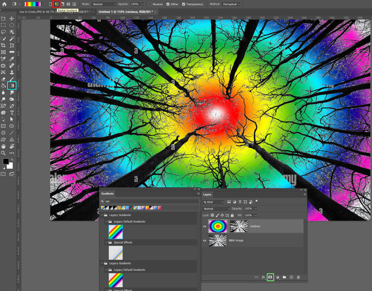

You can't use colorize, or the color blend mode over white.  It just won't show.  So you'll need to select the wite area and use a mask.
Place the rainbow in a new layer above the B&W image.
Turn the rainbow layer off and Select the white area with the magic wand tool.
Turn the raibow layer back, and give it a layer mask.
I am sure you'll know that there is already a rainbow gradient available.  If you open the gradients panel you can use the search bar to find it as gradients are kind of hidden away nowadays.  My green highlight is the add layer mask icon.
Note I have used the radial gradient (my red highlight
Votes
