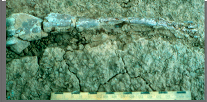

    Hi. I'm brand-new to Photoshop. I've never used it in my life. I have to scan quite a few Kodak color slides. I'm using an Epson 12000XL scanner to do this. They're being scanned as TIFFs, 3000dpi, 24-bit color. When I open them up in Photoshop, they could be a lot sharper. How can I make the images sharper in Photoshop? I've attached one sample slide below (as JPG, 3000dpi, 24-bit color). Notice that the edges of everything are kind of blurry. I'm using Photoshop CC 2017, and I'm on a PC. The images will not be printed out; they will be used on a PowerPoint presentation. The person in charge of the project wants them to be at 3000dpi.
Please be kind. I am brand new to this. Many thanks!

Community Expert , Mar 29, 2018 Mar 29, 2018
The differences between the two images, differences in local contrast (modeling), tonal range, image sharpness and variety of colors makes the matching the images impossible. For the image above, the reference sample was enlarged and silhouetted and added as a layer above the green image. it is at the bottom of the image and has not been modified. This eliminated the distraction of the surround.
Using Curves and Channel Mixer the color was altered to put it in the ballpark. At this point some of

OK the average size of a print is 4" x 6" (or there about). So to see what the actual quality is you take the inch of one side and multiply by the ppi to get your pixel dimension of that side, then repeat.
4 x 3000 = 12000 px
6 x 3000 = 18000 px
An 12000 x 18000 pixel image is more than enough for a print.
So if it is blurry I would say it was due to the camera and more than likely because it was not on a tripod and the camera set to the proper settings for the scene.
It could also be from a low quality lens, especially if the camera was a point and shoot style.
The film it self could also be an issue.
But from what I am seeing, I don't think the issue is the setting from scanning.
Just my opinion. I have been known to be wrong before, so...

Mar 21, 2018 Mar 21, 2018
  • 3000 dpi makes no sense, as the physical resolution is only 2400x4800.
  • do not use sharpening when scanning, except if you know what to do.
  • use dust removel only, when done in hardware.
  • mechanically clean your slides before scanning.
  • colour depth should be probably 16bits per channel.
  • make sure the slides are plane on the scanner, when scanning. Not all scanners allow for that easily.
I scanned my slides with a special slide scanner.
The slides may be blurry, because of the camera used, the film used, the film grain, the processing and they may be further detoriated due to aging.
I do not see your test picture exceptional blurry. Infact we tend to look at the picture at a 100% of the pixel size. You should downsample to the projection size and mount into a powerpoint and project that to see how this works out.
A different thought: At the time, pictures where not as sharp and colour pinched as today. We really fast adopted the special digital style.

Interesting! But I don't see the "Save for Web" option in my Save options. I only have Save and Save As. By the way, there's a new challenge: the eyedropper. My professor would like me to lift the color of the bone to the far right in the pic belowPilbeam12.jpg
and apply it to the bone in this pic:
It's the same bone by the way; it just so happens that the second picture is extremely faded, and the first picture shows the true color of the bone when it was found. Now, I know that this does not involve only just one color, but a full gradient of colors. I started by using the magic wand and outlining both bones as best I could. THEN, I used the eyedropper tool to sample some color from the bone in good condition.....but now I don't know how to "insert" that color into the second bone. I went to Lynda Campus, but the videos for doing this are at the intermediate/advanced level, where they talk about 3x3 pixels, hexa-something. Any "simple" recommendations would be appreciated.
I will continue to look for Save for Web feature in the meantime. And again, as always, many thanks.
Using Curves and Channel Mixer the color was altered to put it in the ballpark. At this point some of the browns are a tad too red, others a tad lacking in red. Contrast adjustment could be made in Lab (L channel) without a color shift and may be needed because all these changes reduced the difference in color of the object from the setting. There have been no local corrections. The setting could be modified on a separate layer, if desired. These notes provide a good start for you on this project. Good luck

Mar 30, 2018 Mar 30, 2018
Wow Norman, This is amazing. I was not expecting anyone to do this, but just give me instructions. Thank you!! And thank you for noting that there have been no local corrections. That's very important.
