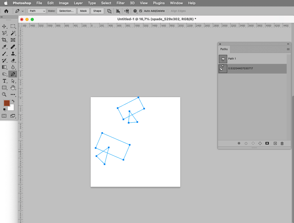

I decided to try this, but I ran into a snag. It seems when you make a shape out of a text layer, Photoshop combines the the paths in each letter, so the cutout in the letter "b" is considered one path. But using a script can't detect the inside, subtracted path, just the points on the outside of the letter.
Apr 07, 2023 Apr 07, 2023
Are you using DOM-code to collect the subPathItems?
AM-code should work out here.
Yes, I was. I will have to figure out AM code, still not to savy with it.
This code is a bit of a hodgepodge but it should serve as an illustration.
It collects the info from the first path in an Array and creates a new Path with two times the elements (scaled and rotated).

I did play with the code a bit. There is still an issue. While it does get all the points, once a shape is merged, the subtracted path from the area inside a letter shows as an operation of add rather than subtract. So reconstructing the shape, you don't know what paths need to be subtracted and which need to be added. I suppose a work around, migh be to use a combination of DOM and AM, but thinking about that is making my old head spin.
Depending on the actual intention even the Filter Displace (with a 2 Channel Cloud Displacement Map) might prove useful.
