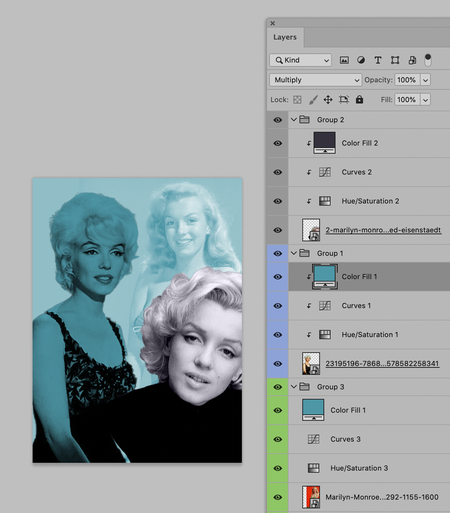

I think you should try to keep all the Adjustments editable, so either Adjustment Layers or Adjustments applied to Smart Objects.

I see what you are saying,  the result looks very good in your example thank you .
How did you set up the Hue/Saturation 1 ?
Votes
Apr 05, 2020 Apr 05, 2020
Copy link to clipboard
Copied
Hue/Saturation is set to -100 Saturation.
