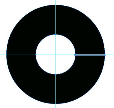

Is there anyway to put text inside a shape but constrained to the actual shape? I would like to be able to make a complex or simple shape, fill it with text and have the text flow throughout the shape without crossing the boundries of the shape. In the example below, the black ring/doughnut is the shape. However when the text tool is selected and the cursor moved over the shape it changes to the circle icon indicating it is placing the text in the shape. But, all it does is place the text in largest diameter and does not flow within the shape at all, it acts as if it is just one big circle. That is not what I want or need. How can I make Photoshop flow the text only in the black shape and not across the hole in the middle of it?

You can do it in Photoshop but you have to pull off a little trick.
Add a small rectangle with path operations set to subtract to cut a slot into your circle
Now add your text
Then go to the shape and using the path select (black arrow key) and delete key, remove the slot
Now add your text

Thank you Dave! That worked like a charm! I tried to do it in Illistrator but couldn't make it work. Your 'trick' for doing it in Photoshop works great.

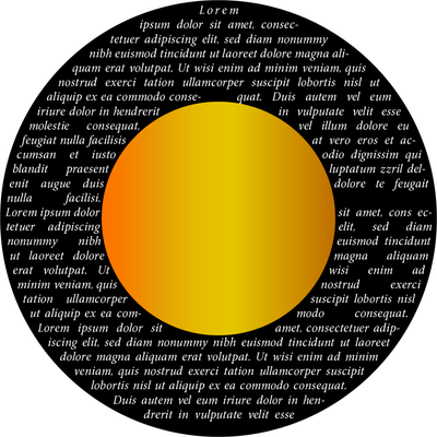

It can be done in Illustrator. Are either of these what you are looking for, and do you have Illustrator?
~ Jane

Thank you Jane for the reply. I do have illistrator but I have no idea how to use it. 🙂 I've tried to learn it but none of the tools work the same as the ones in Photoshop and it's such a headache to switch between the two to do something that should be able to be done in one application. To me, Illistrator is a hard to learn program. In your example, the one on the left is exactly what I'm wanting to do.

  • In Illustrator you simply draw a circle, then use the Type tool and hover over the inside of the circle. Confirm there is a circle, not a square around the i-beam and click inside to get the Lorem impsum text, which can be replaced.
  • A second smaller circle has Text Wrap (Object Menu). I used the default of 6 pts, but that can be adjusted at any point.
  • I've just now added a third larger circle in the back and made it black to look more like yours.
  • I did not, however, use red text on a black background, as that is one of the first things that comes up for readability warnings. For some people, the two colors become one. For the rest of us, it's just difficult and that color combination should be avoided.
