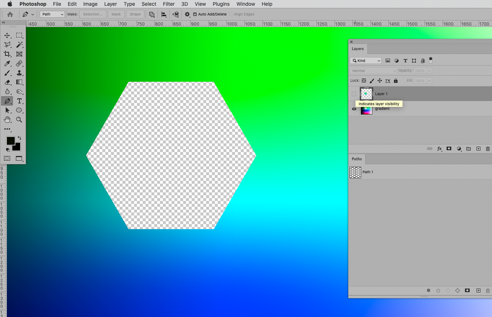

I guess starting with hexagonal paths and using them to create Selections without Anti-aliasing would offer an option.

Jan 29, 2022 Jan 29, 2022
As the third screenshot shows the two Layers match »perfectly« if the Cut is based on a non-Anti-aliased and non-feathered edges.
Depending on the number of hexagons the task may be tiresome to be done manually so if the task is a frequent one a Script might be worth the effort.

You could use the Polygon and convert the path to a selection.
Another option would be creating the hexagonal pattern in Illustrator and exporting them as psd without Anti-aliasing.
Then Clipping Masking Smart Object instances to the resulting Layers in Photoshop.
That way one can easily switch in different images in the Smart Object and then, if necessary, merge the instances to the hexagonal Layers with an Action.
Screenshot 2022-01-29 at 13.02.01.pngScreenshot 2022-01-29 at 13.01.42.pngScreenshot 2022-01-29 at 13.09.54.png
