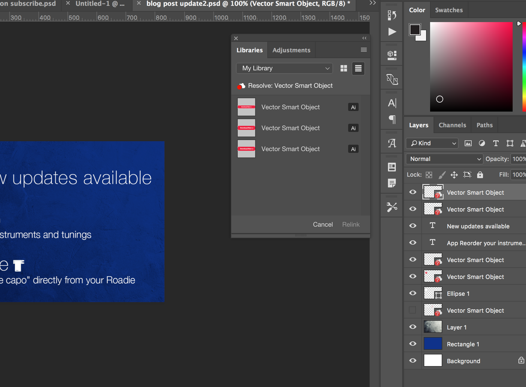

Hey guys,
I was using Photoshop CC normally, copying vectors from Illustrator then pasting it on Photoshop with "Vector Smart Object" correctly linked.
Then for some reason I signed out of Creative Cloud (can't remember why) and when i paste artworks from Illustrator to Photoshop i unchecked "Add to Library"
Ever since i've been using Photoshop files with layers that aren't linked to their illustrator artwork (attached)
My question is, can i relink the missing "Vector Smart Objects" to their original vectors cause i lost many of them.

That's what i thought, but everytime i open a PSD file on photoshop i'm getting this (attached)
That the Vector Smart Objects are missing and that i should link them again. It's the first time this happens with me so i'm wondering why. I don't have each of them as separate illustrator documents so i can't manually pick them cause they don't exist.

I have no idea how to answer that question. i am not familiar with Libraries on Photoshop, ever since i've been using Photoshop for more than 10 years i copy paste an artwork from Illustrator to Photoshop and it automatically links to Illustrator as a Vector Smart Object and it's saved.
Now it's not and plenty of my layers on Photoshop for numerous files i have no access to.
attached reference

I haven't changed my account it's always been the same.. I did however just rebooted Creative Cloud (attached 2) Originally it wasn't there it's been a while so chances are i might have been not signed in?

I have the same issue as you do. I usually just created the graphic in Illustrator and copy and paste into Photoshop as smart objects. Recently, I changed my laptop. All of my smart objects cannot be located in Photoshop and I don't have a copy of all these vector files as well. Hope someone can provide a solution.

Panlau - This is how it worked out with me.
Turns out, for some reason my Adobe Creative Cloud has signed out from my computer, and during that period, all the vectors i copy pasted onto Photoshop from Illustrator didn't register in the PSD file since CC couldn't save them on its "cloud".
Obviously I couldn't retrieve anything, but maybe sharing this will help you out. Check out your sign-in status on CC.

I'm having the same issue, I was passed a file from another artist and they had objects links in their library that did not save with the PSD so now when i open the file its got a bunch of missing library objects.
I have his original AI file... but id want to just auotmatically re-link all the vector links.  is there a way to do it?

I had the same issue...right-clicked on the layer and selected "Convert to Smart Objects". The red missing link icon in the layer is gone and all seems to be fine.
