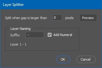

How to remove option window from this script and set OK by default?
Engaged ,
Jun 18, 2023 Jun 18, 2023
I have following script that split image contents to specific layer:

//Change any of the following 5 values to customize the default options for the script:
var showOptionsDialog = true; //Set to false to disable prompt to user.
var tolerance = 0;            // the largest gap of transparent pixels that will be ignored. Also sets default
var confirmThreshold = 20;    // If the script is going to make a large number of layers, prompt user to confirm that this is OK
var suffix = " - ";           // Add this to the Layer name of new Layers.  Set to "" for no additions.
var addCount = true;          // Add a numeral to the end of each new Layer
var layerNamePreview=activeDocument.activeLayer.name + suffix;

function main() {
    var ok=createDialog();
    if (ok===2){
        activeDocument.selection.deselect()
        return false;

function createDialog(){
    var dlg = new Window('dialog', 'Layer Splitter');
    dlg.alignChildren ='left';
    dlg.gap = dlg.add('group')
    dlg.gap.orientation= 'row';
    dlg.gap.txt=dlg.gap.add('statictext', undefined,'Split when gap is larger than');
    dlg.gap.input=dlg.gap.add('edittext', undefined,tolerance);
        dlg.gap.input.preferredSize = [20,20];
    dlg.gap.txt2=dlg.gap.add('statictext', undefined,'pixels');
    dlg.gap.btnPreview= dlg.gap.add('button', undefined,'Preview');
        dlg.gap.btnPreview.preferredSize = [55,20]
    dlg.naming = dlg.add('panel',undefined,'Layer Naming')
    dlg.naming.alignChildren ='left';
        dlg.naming.suffix = dlg.naming.add('group')
        dlg.naming.suffix.orientation= 'row';
        dlg.naming.suffix.txt=dlg.naming.suffix.add('statictext', undefined,'Suffix:');
        dlg.naming.suffix.input=dlg.naming.suffix.add('edittext', undefined,suffix);
            dlg.naming.suffix.input.preferredSize = [60,20];
        dlg.naming.suffix.chkbox = dlg.naming.suffix.add('checkbox', undefined, 'Add Numeral')
            dlg.naming.suffix.chkbox.value=addCount;
        dlg.naming.txtPreview = dlg.naming.add('statictext', undefined, layerNamePreview)
            dlg.naming.txtPreview.preferredSize = [200,20];
    dlg.btnPnl= dlg.add('group');
    dlg.btnPnl.alignment ='right';
    dlg.btnPnl.okBtn = dlg.btnPnl.add('button', undefined, 'OK', {name:'ok'});
        dlg.btnPnl.okBtn.active=true;
    dlg.btnPnl.cancelBtn = dlg.btnPnl.add('button', undefined, 'Cancel', {name:'cancel'});
    dlg.naming.suffix.input.onChanging= function(){
        layerNamePreview=activeDocument.activeLayer.name + dlg.naming.suffix.input.text
        if (dlg.naming.suffix.chkbox.value === true){
            layerNamePreview += "1"
        dlg.naming.txtPreview.text =layerNamePreview
    dlg.naming.suffix.chkbox.onClick = function(){
        dlg.naming.txtPreview.text = layerNamePreview;
    dlg.gap.input.onChanging = function() {
        if (parseInt(dlg.gap.input.text) == 1){
            dlg.gap.txt2.text = 'pixel'
        }else{
            dlg.gap.txt2.text = 'pixels'
        tolerance = parseInt (dlg.gap.input.text)
    dlg.gap.btnPreview.onClick = function() {
        makePreviewSelection()
    x=dlg.show();
    suffix = dlg.naming.suffix.input.text
    addCount=dlg.naming.suffix.chkbox.value
    return x;
but this script at start running show following window:
How can i remove above window from script and set "OK" by default?
even i changed var showOptionsDialog = true; in line 16 to flase but still i get that window!

Engaged , Jun 19, 2023 Jun 19, 2023
quote
It's not that simple, as the values that would need to be input via the GUI would need to be hard-coded into the script where the "hooks" to the GUI were previously set.
By @Stephen Marsh
i found a solution for this problem!
Try replacing the var showOptionsDialog = true; with var showOptionsDialog = false; and the var ok=createDialog(); with var ok=true;
Adobe
Engaged ,
quote
By @Stephen Marsh
