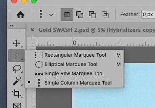

Now, in addition to Kevin's suggestion above, there is a cool little known tool you can use to copy and paste 1 column of pixels at a time:
Select the Single Column Marquee Tool to select the column next to the missing row, copy it and move the selection over one pixel and paste. It is not fast, but it is accurate.
