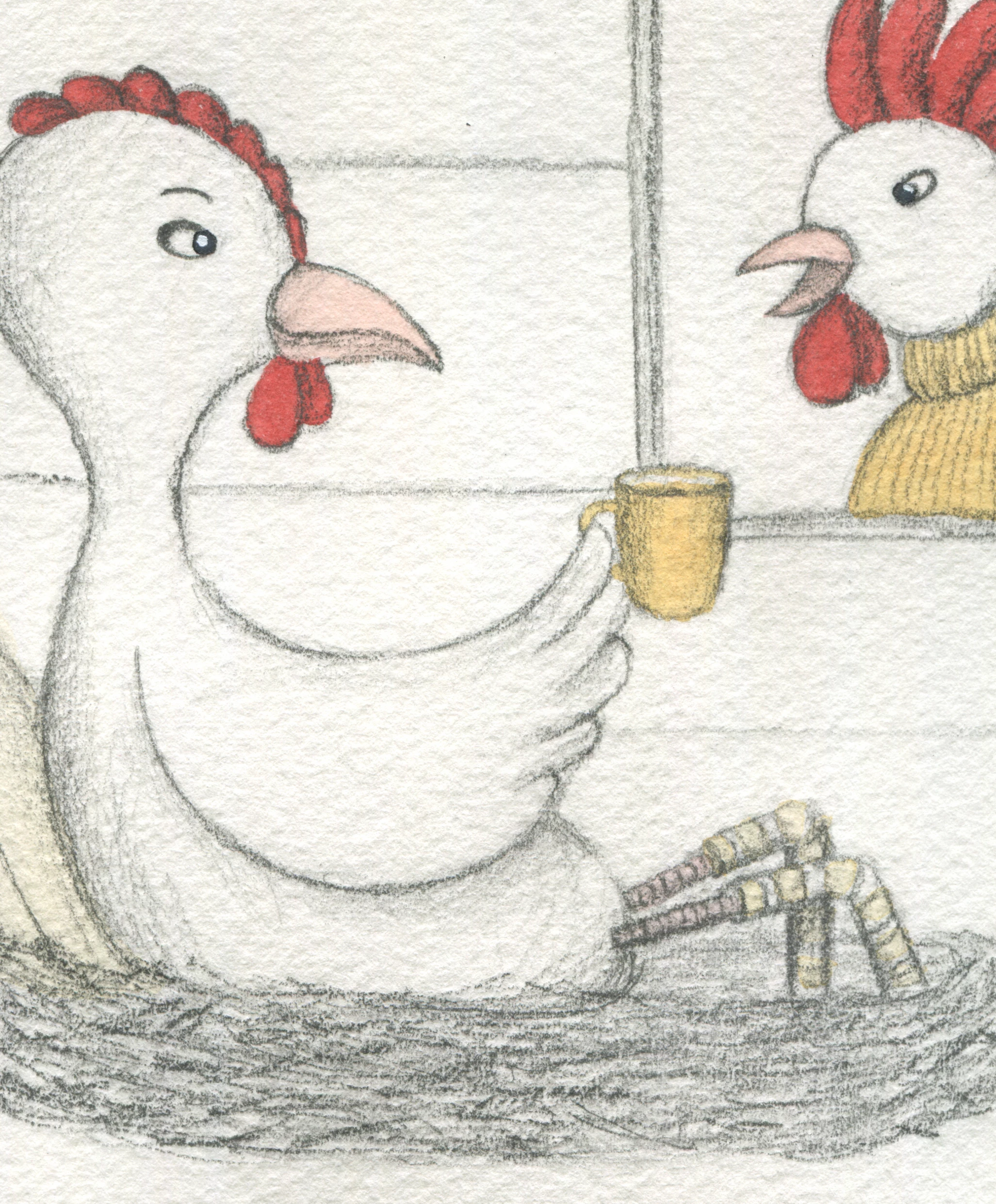

Hi) I can't find a good way to remove watercolour paper texture from my image. A part of my drawing:
How would you remove the texture og save almost all pencils lines and colours?

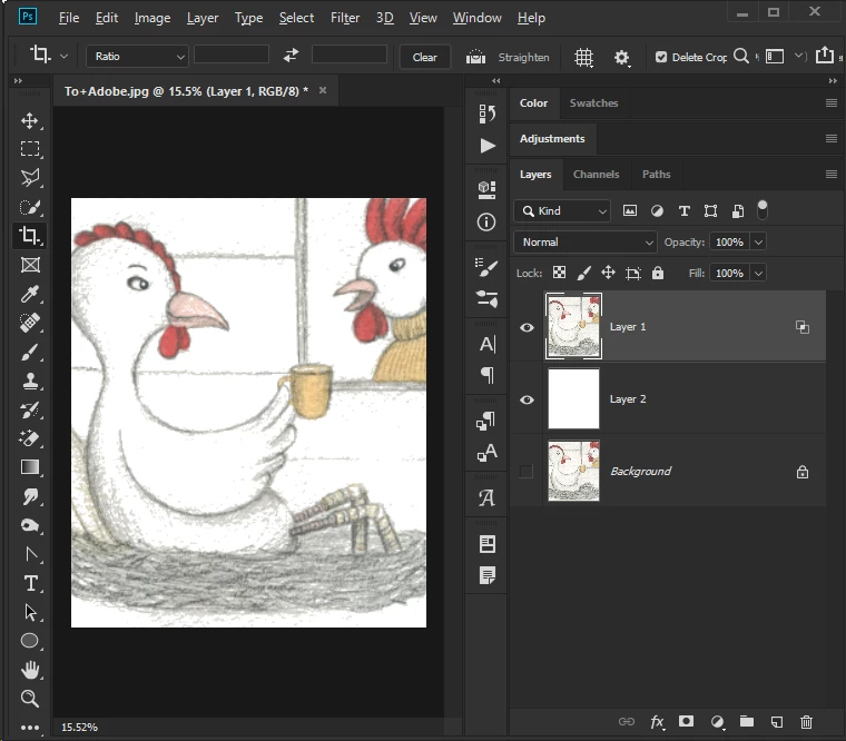

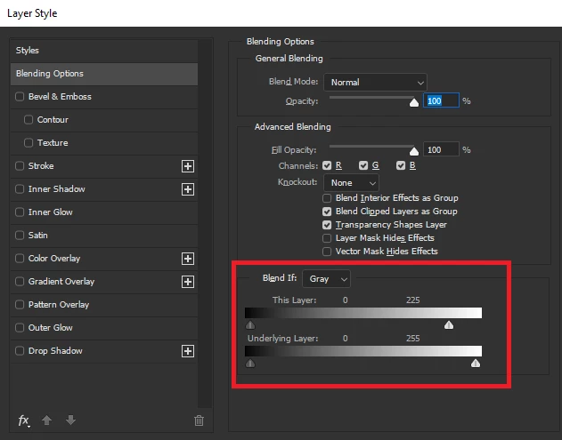

    Hi
    You could try using Blend If
    Or a Levels adjustment layer

    You may also find that this alternative at the settings shown in Surface Blur holds the image color, very light lines and the color. of the paper without the texture,.

    Ged Traynor, thank you for your answer!! This way is completely new to me. Now I have an another problem: When the paper texture is removed, some colours part are also removed. Can I do something to avoid that?
    February 8, 2019
    You've taking the slider to far, try using the Levels adjustment I mentioned above instead
