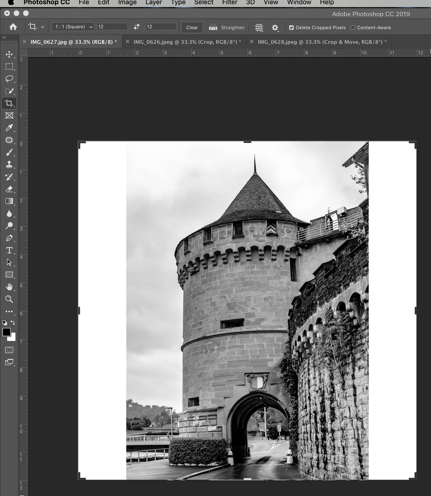

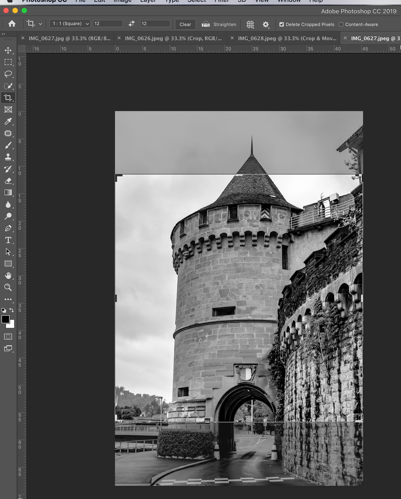

Community Beginner ,
Mar 23, 2020 Mar 23, 2020
Screen Shot 2020-03-23 at 1.21.41 PM.pngScreen Shot 2020-03-23 at 1.25.08 PM.png
Mar 24, 2020 Mar 24, 2020
Well, in the upper screenshot you obviously didn’t follow the recommendation, in the lower one you reveal that you chose an image that is unfit for the task without applying some distortion (assuming you wan tthe tower to be visible in its entirety).
In the upper photo I first went Image - Image size - changed width to 12".  Then Image - Canvas size - changed height to 12".  Is that wrong?
Mar 25, 2020 Mar 25, 2020
It seems you are not describing what you really did on the upper screenshot – changing the image’s width to 12 inches in the Image Size-dialog would not add blank space.
As for the lower screenshot: If your problem is that the tower is not visible in its entirety in a undistorted square format that is the problem with the image you started with and not Photoshop’s doing.
You can (as mentioned by others) try content-aware options (Content-Aware Scale, Content-Aware Fill, …) to add content left and right or you can manually create additional content left and right (with the Clone Stamp Tool etc.).

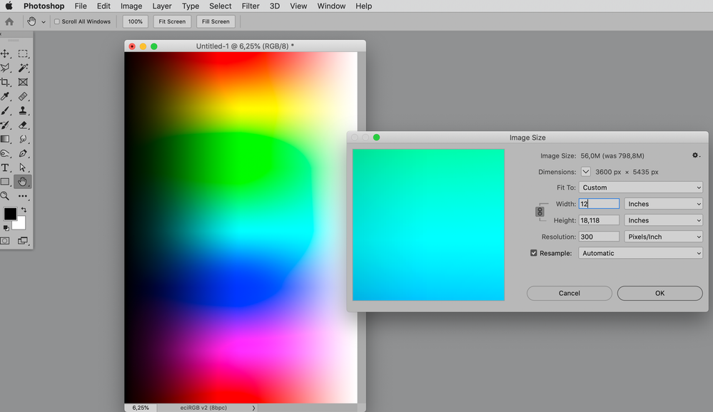

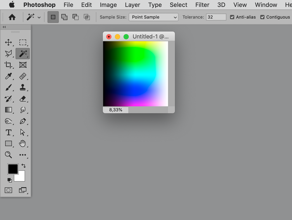

Screenshot 2020-03-23 at 18.44.36.pngScreenshot 2020-03-23 at 18.44.52.pngScreenshot 2020-03-23 at 18.45.06.png
