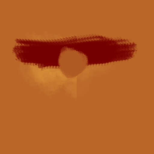

So, here's what we are looking at - 2 layers, one on top with varying levels of opacity and using a blend mode to inherit color from  the layer below.
The goal is to remove the base layer and maintain the color and opacity information.
The top panel is the end result that I'd like to achieve, except it has the inconvenient element of needing a sold background and thus cannot use transparency.
The second panel is what the layer looks like without a background to color it.
The third panel is what happens when I combine the top and background layer, and mask with the top layer's opacity. It is an attempt to capture the spirit of the first, but as you can see, the brighter, more saturatted yellow/gold color is lost. (I split the background against the original ochre color and white for comparison)

Yes, that is the 3rd panel.
First I copy the transparent layer (so that I will still have something to generate a mask from after merging)
Then I merge the background and transparent blended layer to flatten it. This is my baking step.
Next step is to CTRL+Click the preserved transparent layer to generate a selection
Last step is to mask the merged layer to add transparency back into the baked layer
As you can see, this does not preserve the effect of the original blended layers.
Or maybe I am missing a step?

Have you tried it?  It certainly does not produce the same effect on my end.
Is there something special with 'copy merged' as opposed to making a copy of the transparent layer before merging and then masking?
The issue with this approach is that the selection does not acquire the full bit depth of the transparency, so applying a mask from that selection masks color details that should be preserved.
Adjusting the 'Density' attribute brings the color information back but doesn't descriminate the overall opacity channel. And I'm not seeing a way to apply a curves or levels adjustment to the opacity channel, which seems to be a limitation of Photoshop's.

It looks like there is no actual feature for baking blending modes into transparent layers, but one can manually adjust the alpha curve to arrive at a close approximation.
So, the transparency selection is discarding like 80% of the gamut. I can get it close to the merged after a curves adjustment to the mask. I guess the real question is how to ask Photoshop to grab the full transparency range? It's like it's doing an 8-bit depth grab when it should be 16 or 32.
This might be OK a lot of the times but is quite the workaround for something as simple as what could be a merge (RGBA) operation. And it is imprecise, what factor of transparency is being discarded?
