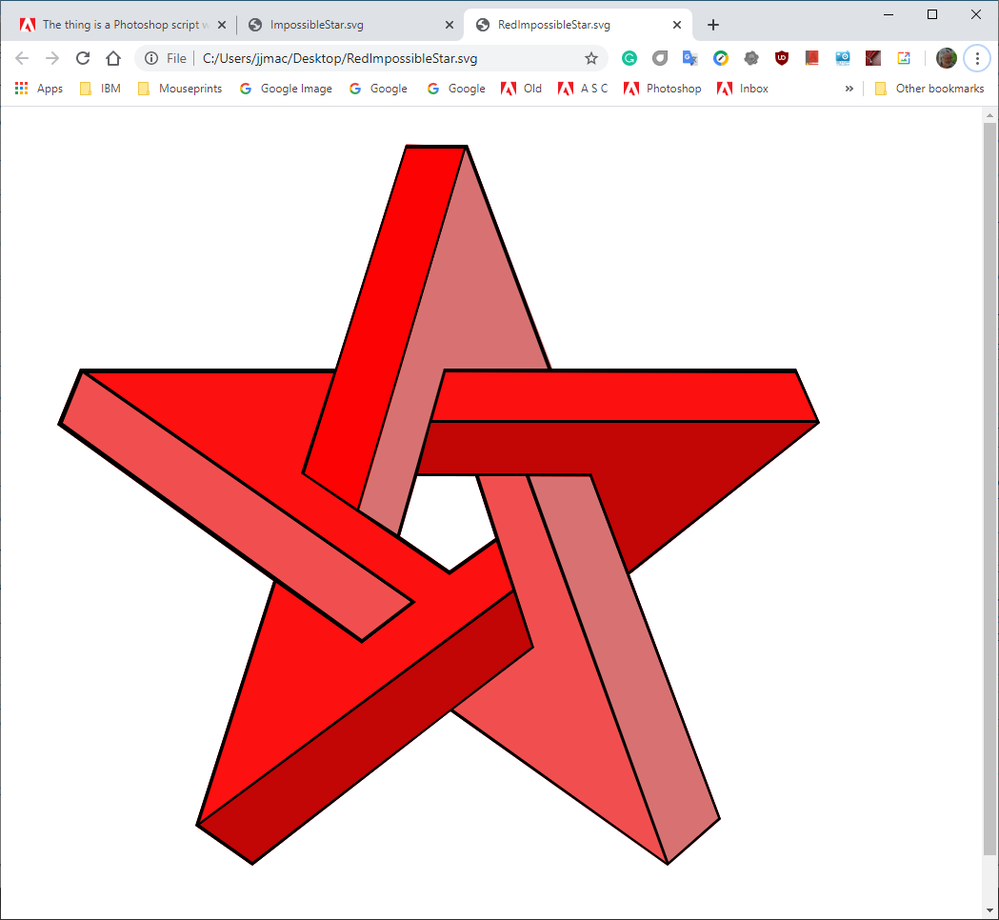

Here is a Shape layer I exported as a .svg file. Included here in text format.
<svg xmlns="http://www.w3.org/2000/svg" width="3200" height="3200" viewBox="0 0 3200 3200">
  <defs>
    <style>
      .cls-1 {
        fill-rule: evenodd;
    </style>
  </defs>
  <path id="Impossible_Star_1" data-name="Impossible Star 1" class="cls-1" d="M1862.17,400h259.68l351.56,993.39H3500.12L3600,1634.35l-799,672.12,383.52,1086.4L2960.8,3600l-910.86-684.81L1218.98,3600l-239.7-177.54,327.594-1086.4L400,1642.8l95.88-249.41H1566.54Zm4,16.909L1438.7,1858.39l219.73,156.41L2105.87,416.909h-239.7Zm247.69,4.227L1666.42,2019.02l159.8,109.91,195.75-735.54h435.46Zm-83.9,989.164-55.93,211.36H3584.02l-87.89-207.13Zm-1498.125,4.23L1906.12,2429.06l-227.72,186-359.55-270.54-319.6,1061.03L2309.61,2374.11l-67.91-211.36L2045.94,2310.7l-623.22-452.31,135.83-443.86H531.835Zm-23.97,0L423.97,1634.35,1678.4,2593.92l203.75-164.86ZM1970.04,1634.35l-55.93,224.04H2641.2l155.8,435.4,787.02-659.44H1970.04Zm-59.93,236.72-71.91,266.31,207.74,152.18,191.76-143.72-83.89-274.77h-243.7Zm259.68,0,231.71,760.9-339.58,274.77,890.89,676.35L2365.54,1871.07H2169.79Zm211.73,0,583.27,1712.02,207.74-194.45L2633.21,1871.07H2381.52Zm-67.91,515.72L999.251,3418.23l219.729,164.86,1170.53-955.35Z" transform="translate(-400 -400)"/>
</svg>
Here is how Chrome displays thet .svg
JJMack

Photoshop can not export AI files it does not support them. It can only rasterize them or ues them as smart vector objects.  Vector Smart object only resize via vector graphics because Photoshop reprocess the AI file at the required resize by rasterizing the smart object vector file at the required size there are no vector actually in Photoshop.
Even exporting .SVG may not be the file that AI would create for the same image for AI is a vector editor and has more vector tools and features than  Photoshop.  I show a .svg exported for a shape layer the looked most likely line one AI would have saved. AI has tools photoshop does not have and may be able to  fill and shade areas with different colors.  I do not install AI so I'm have idea as to what tools and features  AI has.  I filled in that star ares with a Raster layer  containing several  colors.  When I exported it as a svg the svg files contain both vectors and raster data. Which  most likely would be very different than an AI svg file.
It is SVG file but not like the one that would have been create with the tools available in AI. Photoshop has limited vector support.  Smart object layers pixels act like a raster layer normally. Only AI  file are resized via rerasterizing that object ai file at the correct size. What is in Photoshop is a raster layer. Not a vector layer.
As I wrote the Photoshop Script would need to use JavsScript to do a file copy of the Temp work AI file that photoshop created in your system temp space. Or you save the AI file where you want it when AI opens the temp Work file.
