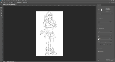

I have a digital sketch I've recently finished, and I want the insides of the lines selected so I can add a Mask layer. If I hold Ctrl and left click on the layer, it just selects all the edges instead. So when a mask is applied, only the lines/edges appear white and the insides are black. Apart from using the Quick Selection or Magic Wand Tool, and systematically click on every empty space, is there a quicker way of doing it? Thanks.
This is the sketch in question:

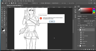

Unfortunately when I do that, I get a warning saying the following...
Jun 15, 2020 Jun 15, 2020
I said »inverting … the Selection«, but you seem to have tried applying the Adjustment »invert«.
Try
Select > Inverse

Jun 16, 2020 Jun 16, 2020
That's it! That's done it! Thank you. 😄 Just a few little areas that need painting over in the mask, but that's got it. 🙂
