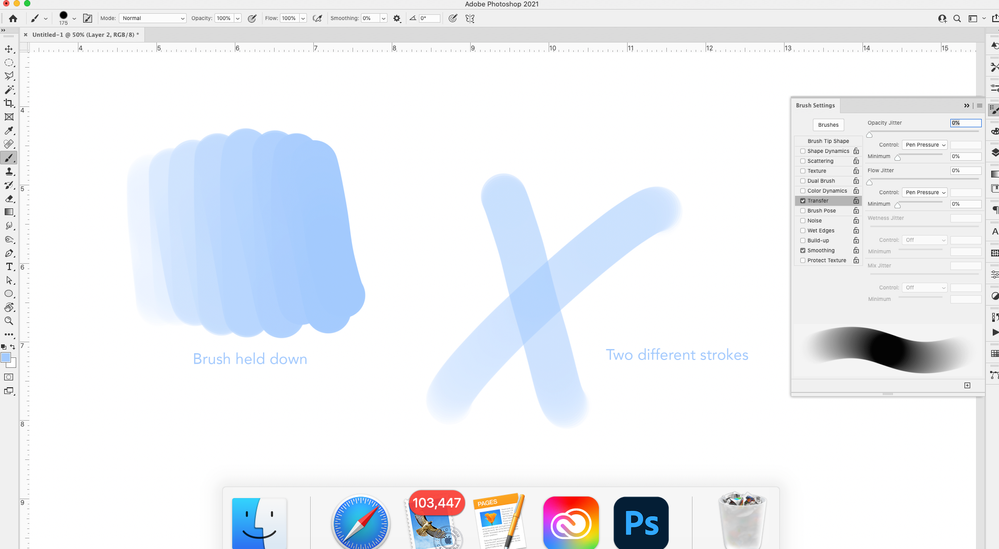

I have been so confused about this. When I use a hard brush, I keep getting an "additive" effect similar to a watercolor when I go over a previous brush stroke. I don't want this to happen - if I have the brush opacity set at 100% and to change according to pen pressure, I would like each stroke to remain distinctive, not have the previous stroke affect it. (See example that says "stroke 1" and "stroke 2").
Also, even if I hold down the brush the whole time, I feel like I'm also getting an effect I shouldn't beg etting. (See example that says "Continuous")
I don't think this used to happen, especially as in the first example - this effect makes shading incredibly difficult if not impossible. I feel like when I watch videos of people shading or even just painting they are not getting this build-up effect. What gives?

Same thing happens, see new screenshot:
Jun 25, 2021 Jun 25, 2021
Your Opacity Jitter and Flow Jitter are both set to Pen Pressure. If you set these to Off, does it achieve what you want?
You have opacity and flow jitter both set to Pen Pressure, which is why you are laying down semi transparent strokes.  So it is working exactly as it should.  The only way to get  strokes like that without subsequent strokes making previous strokes denser is to turn off opacity jitter and lower the layer opacity.

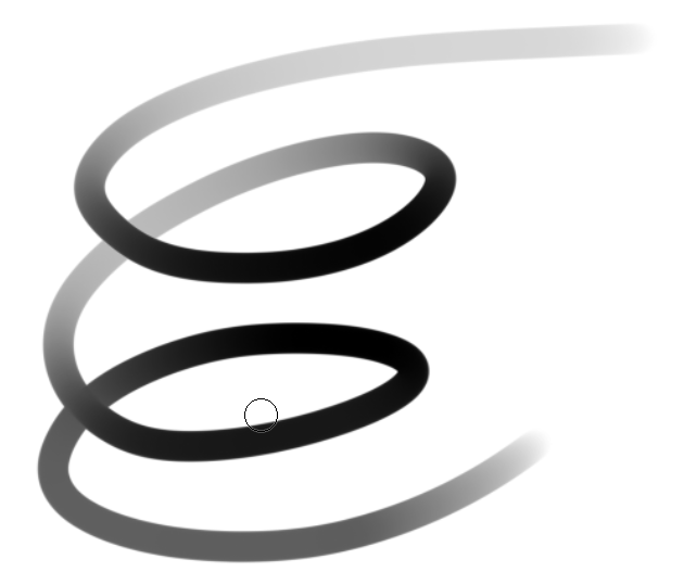

How well do you understand the Brush Engine and how the various controls work?  I'm going to assume that you are not 100%, so I apologise in advance if I am telling you things you already know.  Let's start by accepting that yoou had opacity and flow jitter set to zero, but the control is set to pen pressure.  I've always thought those settings could be confusing.
Jitter adds a random element to the brush stroke.  I've set brush spacing to a very loose 40% to better illustrate what is happening, so with opacity jitter set to 100%, you can see from the brush preview that each touch down of the brush has a random density — in this case ranging from 1% to 100% opacity)
Control has a loose association with jitter because it removes the random element, and gives us choices on how to control the setting.  You had it set to Pen Pressure, so the harder you pressed with the stylus the more opaque the stroke
You can see I started with a very light touch, and varied the pressure finishing on a lighter touch again.
I've never thought to combine pen pressure with random jitter, but it just means that when you apply a firm pen pressure the random element comes back into play.
The only other control I find useful is Fade.  The value controls each stamp of the brush, so the stroke goes from 100% to fully transparent in 1000 stamps of the brush.  Note I bought brush spacing down to 10% for this example.

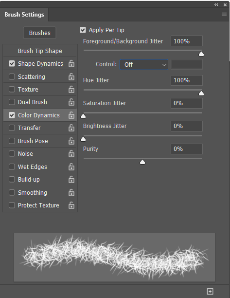

Lay down some random strokes on a new layer and go Edit > Define Brush Preset
Give about 50% size jitter and 100% angle jitter
Now give it 100% Foreground/Background jitter and 100% Hue Jitter
maybe add some scatter, but not much (I used 40%)
Make the foreground and background colours nice bright fully saturated colours
I decided to set size jitter to Pen Pressure
The best way to learn the brush engine is to play with it. It's a lot of fun and you'll discover all sorts of cool effects.
