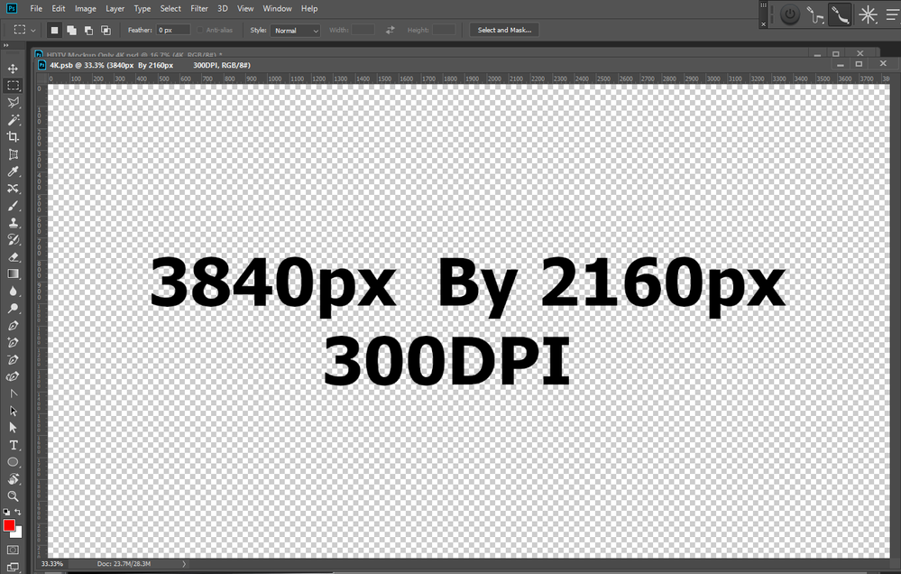

You are confused about dragging and dropping images on smart object layers.  That does not  replace or change the layers smart object. Dropping an image onto a Photoshop document will create a new layer in the document.  You cam change the Smart object  using replace content or opening the objects and change the object and committing the changes in the work file. When Photoshop see the work files has been updated it will updated the layer's smart object and generate new pixels for the layers content.  All smart object layers that share the object in the document will have their pixels replaced.  Using Ctrl+J or Layer duplicate is often use in mockup templates to create layer that share an object.  Each smart object layers associated layer transform will position scale and distort the object for its use in the mockup's composite.   Often the  top of the layer stack contain smart object layers the have other layers the share these object.  The top later visible is often not visible fill, opacity can be set to 0 and the layer visibility can be set off.   It is easy to batch populate these mockups templates all a script need do the to update the top smart object layers objects in the layer stack using replace content or editing the existing object.There need to be a replacement object queue for each  of the top smart object layers. Photoshop Photo Collage and Mockup Toolkit
10 Smart object layers tha all share the same object. The ate 10 different associated layer transforms foe that object/  The tou  layer not visible the othe nine are. The object is am image with transpatent gackgroumd 3840x2160 with black texy 3840px By 2160px  300DPI
JJMack

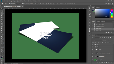

The opposite of your question is my problem.
I have two smart objects but I just want to update one at a time.
It seems the two keeps updating the same thing for the two objects.
I am creating a business card mock-up and I want to be able to update the front design to the first smart object and the back design to the second smart object.
Anyone know what is happening??
Jul 10, 2020 Jul 10, 2020
No.  It most likely your template is not compatible.  With what you post we can not see you template structure. Also the script updates all the smart objects you want updated and saves a  jpeg. Your front and back views must be is different areas in a flat jpeg file.  If you want the front and back in the same area you would need a Layered document which would not be usable on the web. You would need to save two jpegs from your layered document one for the front view one for the rear view.  The Script can save one of the Jpeg views and the Layered document if you create the template where either the front or rear view is visible and you check the save psd option. You can use the psd file in Photoshop and  to save the other jpeg image you need.  IMO if you want to waste your time and have thee files for your mockup instead one or two jpegs and have to Photoshop each layers version yourself  you can. Myself  I would go with one side by side front and rear views or two mockups one for the front one for the rear.
JJMack
