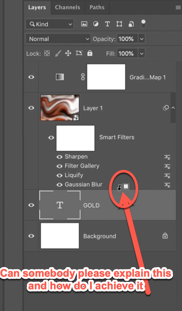

and I have gotten to the point where it shows the following: all was good to that pointHow do I achieve this.png
but no matter what I do I can't work out how or what that means or how I am supposed to achieve it.  Can somebody please explain to me what am I supposed to do with this.  All under the "Smart Filters" are unclickable.

That icon you show is shown when you hold down the alt key and hovers  the cursor between two layers in the layers Palette. When you see the ICON you use a left click to Clip the upper layer to the lower Layer.  The lower layer becomse a clippinf mask foe the upper layer.  So when it come to smart filters you will not see that icon for the filters.  Smart Filters are not layers, they are Filter that filter the smart object layer's object  masked by a single filter mask that masks the object for
Community Expert , Jul 05, 2020 Jul 05, 2020
Hi
To see that icon hold down Alt, hover over the border between the text layer and the layer above (in the layers panel). Then click and the layer above (with its added filters) will be clipped so that it only appears on the text.

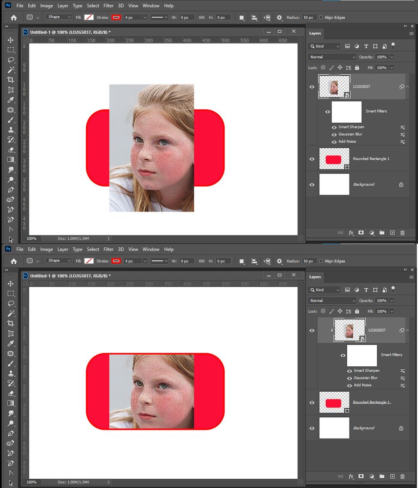

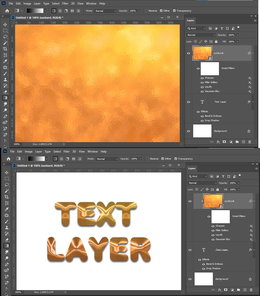

That icon you show is shown when you hold down the alt key and hovers  the cursor between two layers in the layers Palette. When you see the ICON you use a left click to Clip the upper layer to the lower Layer.  The lower layer becomse a clippinf mask foe the upper layer.  So when it come to smart filters you will not see that icon for the filters.  Smart Filters are not layers, they are Filter that filter the smart object layer's object  masked by a single filter mask that masks the object for all the smart filters attached to the smart Object layer  If you see the Icon it will be for the Smart Object layer which is above the attached smart filters the Upper Layer. You can see here that the upper Smart object Layer and all its Smart filters were off set to the right in the layers palette  when I left clicked. Its now clipped the the shape layer. Look a bit like an old mobile Phone
In your Case the Gold smart object texture you created with the smart filters with a left will be chipped to your text layers. It  has be touched by what his face that guy that turns things gold.

Thank you so much.  Hopefully this will save me another day in struggling with this problem.  I wonder why I never got an email notifying me of your reply.  I just popped by by chance and found it.  Thankfully I did

It worked.  Thank you so very very much
