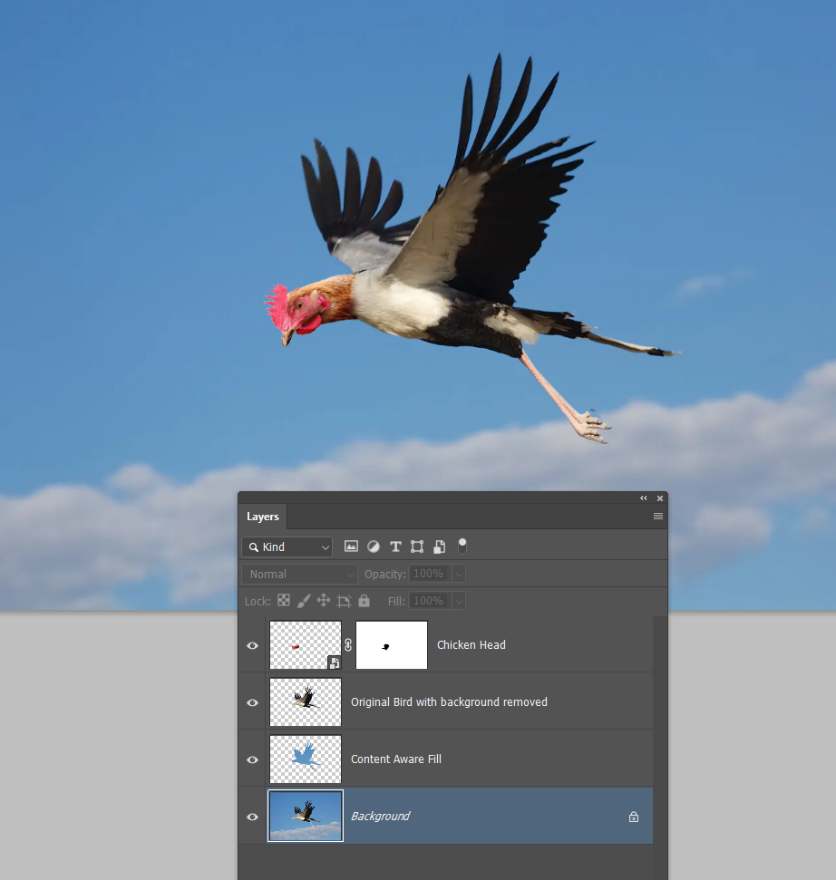

Hi Mark. It's difficult to work out where you are going wrong here, and I have to say, I am not entirely sure what you think is not working. I have started with a bird in the sky and copied the layer, then used Remove Background which creates a layer mask hiding the background.
I think you wanted to remove the bird from the original layer, so if you use Select > Modify > Expand to grab a bit of the sky, you can then use Content Aware Fill to remove the bird.
Which gives you this:
If you want to edit the bird, then maybe right click the layer mask, and choose Apply layer mask
When you have made your edits to the bird thre's no need to do anything else. Save it as a layered .psd file so you can make further changes should you need to, and save it as a .jpg so you can upload to Instagram etc. Is this what you were trying to do?

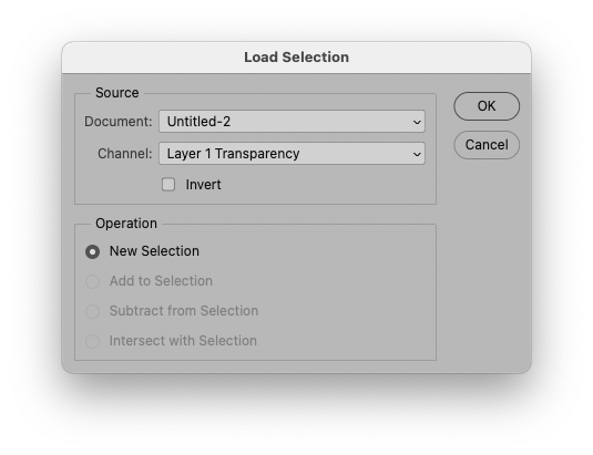

To load the transparency of the Layer with the clipped bird as a Selection ctrl-click its icon in the Layers Panel.
Alternatively you can Select > Load Selection and select the correct Layer.
