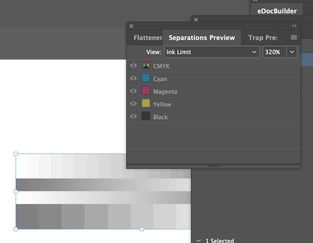

Oct 25, 2024 Oct 25, 2024
@janie k
I have obviously been out of day-to-day InDesign prepress for too long!  :]
OK, the answer is that InDesign will show a warning for 320% total ink when the image has 320% total ink:
However, if the image is under 320% (Perceptual conversion), such as 317% (Relative Colorimetric conversion with BPC), then no overlay is shown:
If you simply up the total ink to 322% then the 320% image will no longer trigger the overlay:
