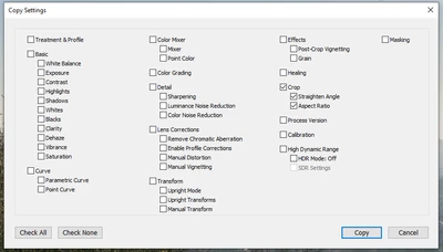

At lower left of Develop are buttons Copy and Paste. You can also use standard key shortcuts Ctrl+C and Ctrl+V respectively. Copy with a chosen source image active, opens a dialog where you can select which aspects of this particular image's current editing you will want to transfer. Any aspect left un-checked here, is going to be left alone on the target image, when you later Paste what you have copied.
Currently there may be a number of aspects (other than crop) checked. For convenience there are buttons to check all or to check none. The latter button is a good idea here. Then you can put a checkmark against whatever aspects of cropping you want to transfer onto another image. The main Crop option refers to position in the image, angle, size, shape - everything - though when the source and destination images are of different orientations, the result is a bit non-obvious. If you check only aspect ratio, and/or only straighten angle, without the main Crop option checked - you are copying only that stuff across without imposing the same position in the image, or the same size.
Then you highlight another image, or several, and click Paste. If AutoSync is active, all the highlighted images receive that update - if not, only the most-highlighted current active image does."

33m ago
