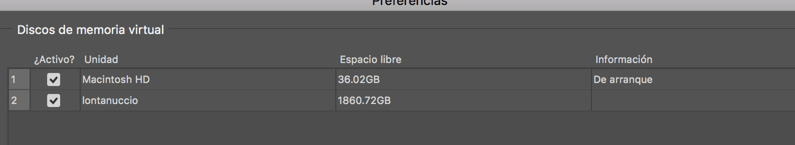

I'm actually using points per inch (double checked). How can I check what am I using as scratch drive?

  I've adjusted the scratch disk as you suggested. I've noticed a slight enhancement, but the brush still lags. Maybe none of the scratch disks currently available are enough to offer a better performance. Shall I get some extra hardware?
I understand smoothing is only activated with mixer (blend) brushes, however this lag happens with every one at bigger sizes.
As I suggested in my first entry, I'm at moment seriously doubtful my computer is built for doing this.

32GB is not much space for scratch disk' particularly as that disk is also being used by your operating system.
Your second disk has plenty space but I think you said it was an external disk. If so performance depends very much on how it is connected. Is it USB3, USB3 or other ?
In current versions brush smoothing is available on normal brushes if it is enabled in brush settings. The level of smoothing is then set in the options bar.
Dave

   I'm using a regular 2 TB Lacie external disk, connected through an USB-C (3?) port.
Aug 05, 2018 Aug 05, 2018
Just as a trial, try clicking the arrow at the right  to move the larger drive up to the top of the list and uncheck the Macintosh drive. Then close and restart Photoshop. My thinking is that if the scratch disk grows too large in fairly small remaining space you could start affect the performance of the Mac.
You can always put it back if it has no effect.
Dave
This isn't about file size. Even at pixels per cm instead of inches, it's 9000 x 9000 pixels. That's big-ish - but nowhere near bringing a computer to its knees. 30 000 x 30 000 might do that.
This sounds like scratch disk problems, not enough of it.

  As Dave suggested, I've adjusted the scratch disk preference as you may see in the screenshot. But while this enhanced brush performance, it doesn't quite get rid of the lag. I assume there's still not enough scratch memory. Would another piece of hardware fix this? (other than, obviously, another computer)Captura de pantalla 2018-08-05 a la(s) 13.13.53.png
