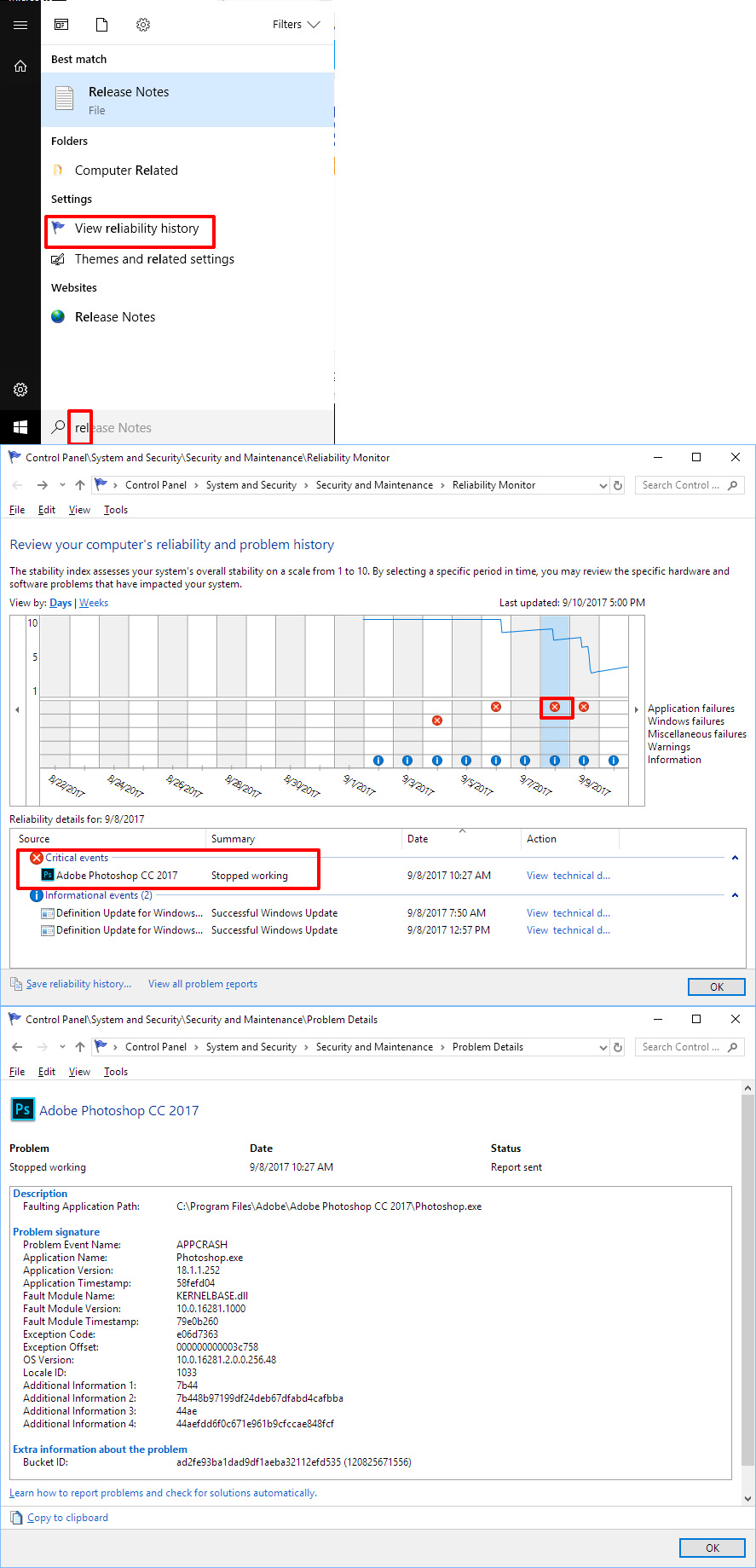

If Photoshop crashes are the any crash reports details you can post? CC 2017 crash.jpg

Here is a crash report - strangely not all the crashes are showing in the reliability report

That type of crash  I find are usually is related to your graphics, Check that you have the latest device driver available for you display adapter and you do not have two different GPU enabled for Photoshop use.
There are other crash reports that Adobe generates that get sent to Adone there is a Popup dialog to send them or not send.
