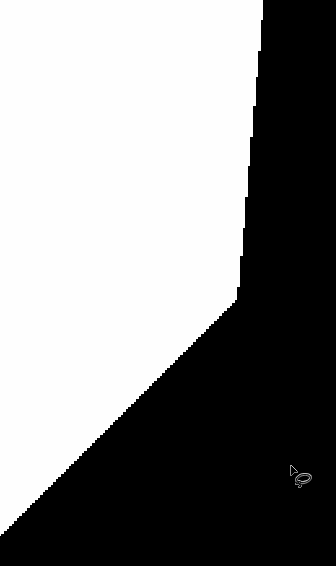

I can see it - when you used the lasso tool did you check Anti-Alias in the options bar?
With anti alias
Without anti alias

Nov 18, 2016 Nov 18, 2016
Jaggies and anti-alias are angle dependent, and the steep angle of your suit lapel is one of the worst possible cases.  I transformed these two layers using Nearest Neighbor which has no anti aliasing, and upresed them 100% for the same of demonstration.  The steeper anger is clearly more jagged.
Plus you have the lapel against a hard white, fully contrasting background, which is making a bad situation worse.  So I would help it out a wee bit.  A soft drop shadow adds a layer of faux anti aliasing, and applying a low value blur softens the hard edge without looking soft because of the slow gradient of the drop shadow.  Shadows also make things look real, because almost everything has some sort of shadow if there is light.
If you want to add texture to the suit material, try using the texture option under Bevel & Emboss which is non destructive, and fully controllable as many times as you need to get what you are after.

Dec 04, 2016 Dec 04, 2016
Thanks Trevor, this was a big help! In particular the blur option.
