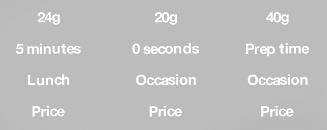

Here is my issue. I am experiencing weird kerning on a load of my text in photoshop
What I have tried so far
- Turning my computer on and off again
- Uninstalling Ps and installing again
- Uninstalling Ps, turning off comp, restarting, installing again
- Resetting the type tool altogether
- Installing an older version of photoshop, back when it used to work
- Rebuilding the file in a totally new file
I am at a loss and need this for work
The words in question:
Here are my type settings:
When I change the kerning nothing happens as well...

Kerning is the space between two letters; tracking is the space between a range of letters. Currently your kerning shows zero and your tracking shows -20.
  • To change the tracking, select the text first. It's a character setting.
  • To change kerning, click in between each pair of letters.
    When text is selected, the kerning control will give you a choice of optical or metrics, which will automatically apply different kerning unless manual kerning has been applied. Yours says 0, meaning text is not selected.
Select your text and show screen shot of your selected text with the Character panel (Window menu).

I have always used tracking at -35
Apologies, I said kerning when in actual fact I meant tracking. You can see the confusion is easy as tracking usually affects kerning of the whole word, no? A small technicality. The other creatives in my team have opened up the file and still have the same issues?
I even created a new file and still experience these issues?

I manged to finally fix this, by deleting Photoshop and not saving any of my presets or plugins and then installing it again

I'm glad you fixed it, but the previous screen shot looks correct for the tracking you used. The font designer made the font to be "optically correct" at 0 tracking, and this correctness is a careful balance of optical illusions, since curves together give a different illusion than straight edges together. By tracking tightly you have virtually removed the space between letters, but the illusion is drastically different between straight edges together and curved edges together; you still have the illusion of space between curved letters even if they overlap, while straight letters merge to one. Every font can tolerate some tracking, but finding the reasonable limit needs an experiment. (In fact it looks as if you did exactly that experiment, and found it too high).

Ahh, maybe I did not explain so well. I wanted the tracking at -35 to tighten up the text for this piece of work. The issue I was having was usually there is equidistant spacing between letters. But, only very recently the spacing had become totally different between letters as seen above. Weirdly it is fixed after my deleting all Ps data and then reinstalling.

That was most likely an issue with kerning. To see the kerning between the letters you need to click an insertion point between them. There is automatic kerning (set by selecting the text and choosing metrics or optical) or manual kerning. Kerning can be adjusting for letter pairs separately from Tracking.
Gutenberg was worried about certain letter pairs, such as AV, AW, Y. , and others. If you look at these pairs even here in this forum, you can see kerning has properly been applied and the second letter is overlapping the space of the first. With kerning of zero, the letters would look too far apart.
