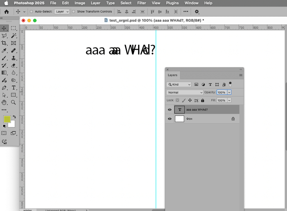

The Script (from the post marked as »correct answer«) seems to insert the kerning before the question mark, as intended.

That's right, but the point doesn't change, look at the kerning before the “d”, it will be 0
where the kerning will be applied, it will be 0 before it

Now I get it; if there is existing kerning (other than 0) one place before the intended kerning-change it is changed to 0.
I don’t know why this happens, though.
Photoshop Type Layers are kind of difficult to Script, I guess.

I did a test; even if I use code created with ScriptingListener.plugin that changes the kerning of two consecutive letters the first one’s is disregarded.
So it seems likely that this is a bug in Photoshop ESTK Scripting.
But as that is on »legacy status« as it is it doesn’t seem worth reporting as it seems unlikely to get fixed anyway.
Edit: It does seem like a bug, but it seems one can work around it.

Please try this, it seems going backwards instead of forwards works out:
