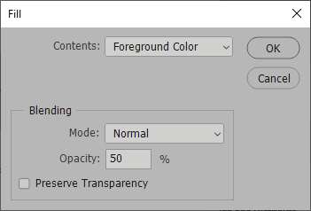

You could do this with a selection on an empty layer, and use Edit > Fill with an opacity setting less than 100%.

John, when would this approach be useful over using layer opacity of a layer mask?  I remember a while back when we had a long thread about Displacement Maps, and you spoke about using colours as oposed to grey scale maps.  So is this an area you are interested in?
Here you go.  I found it.
Nov 17, 2023 Nov 17, 2023
It seems to be an old-school way of doing a layout. I can't think of a reason to use this over a Solid Color fill layer with a mask.
