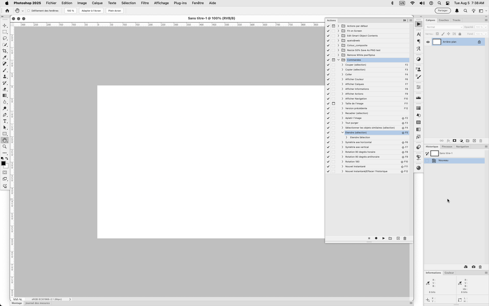

Community Expert , Aug 05, 2025 Aug 05, 2025
Check your Actions panel and see if you have the Commands set loaded, which has a shortcut of Shift+F5 for Grow (Selection) or on the Select menu as Select>Grow, that takes over the normal Shift+F5 shortcut of Edit>Fill.
New Here ,
yes ! That's it ! Thank you ^^
